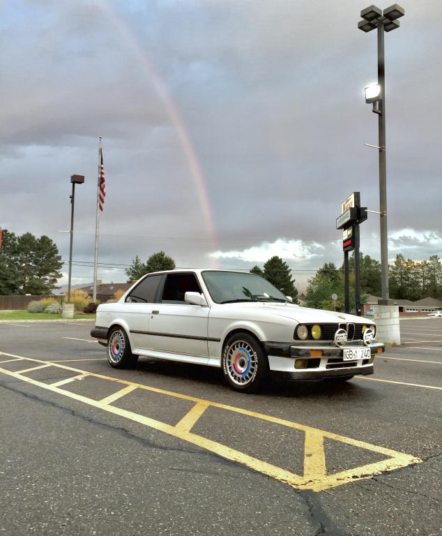

      Awesome pic. I love the rainbow.

        yeah I forgot to mention that's a great pic - love the wheels too!

          Esm-001. They are out of 4x100. :-(
