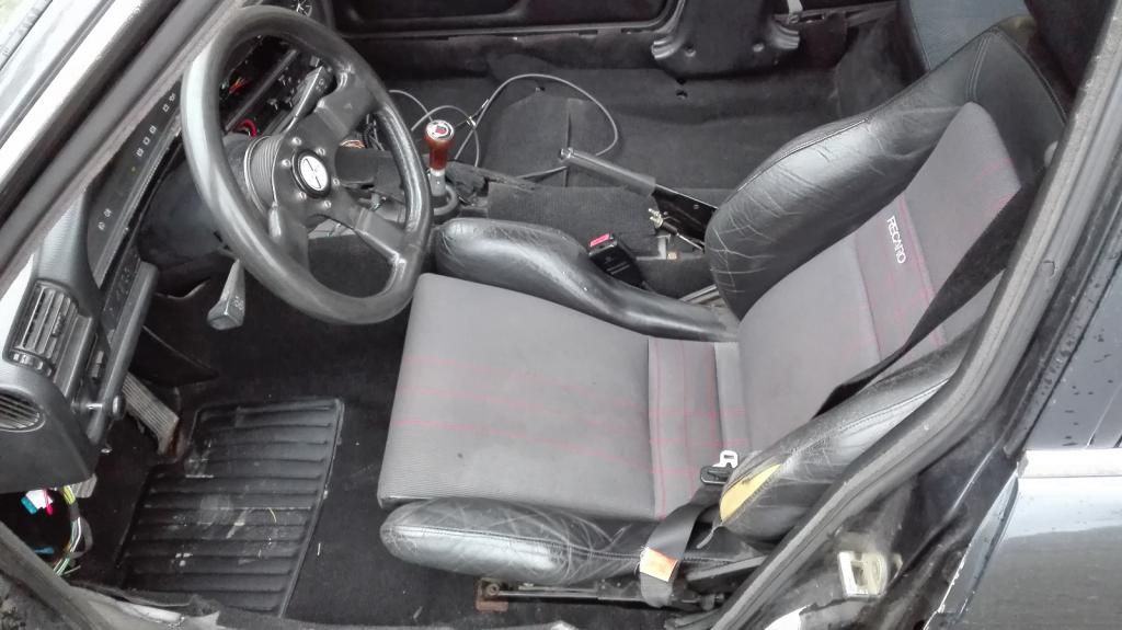

              Here is rwd 2d facelift carpet in prefacelift iX. I added quite a bit of sound deadening on tranny/tc tunnel under the factory carpet, which makes it worse. Doesn't fit 100% right between gas pedal and front seat, but it's not very noticeable compared to original. Too bad I didn't take a pic before fitting the seat..
