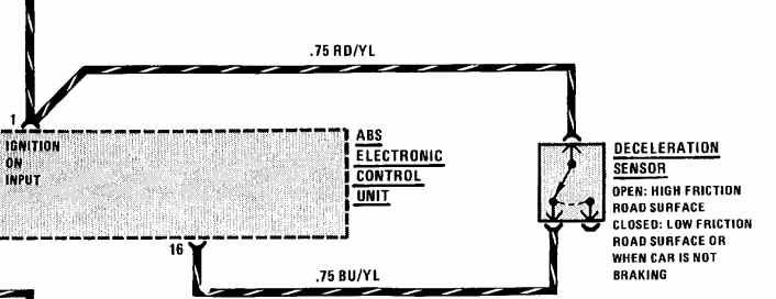

        ETM pic of the decel sensor as attachment.
        -You can just jump the wires to simulate slippery surface (braking or not).
        -Decel sensor disconnected from connector = braking on asphalt.
        Haven't tested if disconnecting the sensor makes the light stay lit on startup.
        Related to this, some might find interesting: the ABS system of the E30 isn't very smart, ie. you can pull off every ABS sensor and have the vehicle pass MOT. Light comes on at startup, goes away -- ABS doesn't work in practice because it doesn't have any speed reference and thinks the vehicle is stationary.

                    i would say that you should fix this issue and see if the abs light goes out before trouble shooting anything else. judging by the electrical diagram posted above, the switch is normally closed. i would assume that the abs controller is looking for this input and not finding it.
                    it seems so ridiculous to me that the p.o. would cut the wiring harness to remove this unless this car was a parts car at one time and it was used to make another ix work.

                      I tested this, it doesn't trigger it in mine. Light comes on and goes out normally with sensor wire disconnected and car stationary.

                          I didn't wait 20 secs in my test, so there's that -- the circuit can be open for 20 secs, after that it lights the ABS bulb. Good find, good to know for possible future troubleshooting.

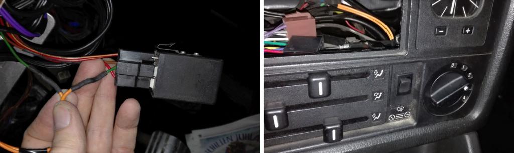

                              Hi, as mentioned it just cuts power from the overvoltage relay. So I cut the green wire near the relay, routed it through a single contact switch back to relay. Wires soldered and insulated with heat shrink tubing. This way one can switch ABS off and back on while driving, without need to switch off ignition. ABS being off is normally indicated by the fault bulb in the cluster.
                              I located the switch where the better equipped models have AC controls. If this is to be permanent, I'll probably seek an old Audi ABS off-switch.
                              edit: added pic
