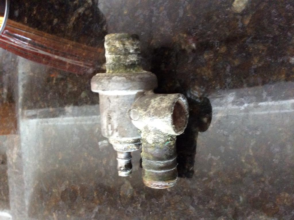

                    Originally posted by Das Delfin
                    muuris, the temp dial is the temperature control knob to the left of the sliders in the hvac control region of the dashboard. A dial is another word for knob. Not a gauge or sensor or whatever
                    The temp dial (in the picture you quoted from me btw) is what governs the heater control valve. The same valve you've deleted.
                    If you didn't know, there was a recall for bmw in america which added another temp cutoff in place of the heater hose that flows from the t stat housing to the heater core inlet. It's a temp sensitive valve designed to cut off heat to the heater core in the event the engine overheats. This can fail and could cause problems similar to what the OP is having I thought you knew about it but apparently you didn't...
                    Sorry to keep revisiting this thread but I am really struggling with lack of heat. Now that we are having this wicked cold snap with temps below zero, the ix is basically undriveable due to the poor heat.
                    I’m wondering if the culprit is this “recall valve” as noted by Das Delfin. I would like to eliminate the valve to see if that restores my heat.
                    I’m struggling with what hose I need to use to replace the hoses used to add in the heater valve. Any help with that would really make my day!
                    Thanks guys!!
                    89 325ix coupe Diamondschwartz
                    1994 Mazda Miata
                    • spdracrm3
                      • Sep 2009
                      • 959
                      Thanks guys!!
                      I would go to parts store a get a flushing kit I think 5/8 hose size and replace the valve first with the "T" to see if it solves the issue(plug the small hose with a bolt temporarily). Then look for the replacment hose
                      Sent from my SM-G360V using Tapatalk
                      Angus
                      88 E30M3 X2
                      89 325IX
                      92 R100GS/PD
                      • E30andy
                        • Aug 2016
                        • 504
                        That’s a great suggestion, thanks spdracrm3!
                        1994 Mazda Miata
                        • E30andy
                          • Aug 2016
                          • 504
                          So I removed the recall valve using the Prestone flush kit. Boy, that was fun....
                          Refilled and bled the system and after an extended drive in 2 degree weather, I hate to say, not much difference.
                          I get some heat with the recirc button pressed, less with it released. With the temp dialed maxed, and fan on 4, it’s acceptable but not hot by any means.
                          Am I just expecting too much from a car designed in the 80’s? Anybody from the arctic north car to weigh in with how their heater responds in this type of cold?
