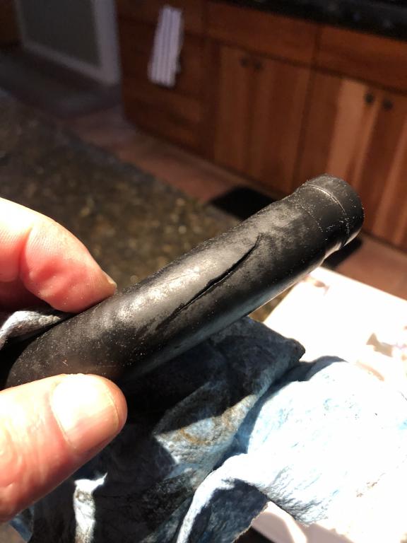

                Found it! Easy fix!

                  The return hose, even. Double easy.

                    Yes sir! Good eye!
                    And the crack was on the top of those so it was easily visible as I was poking around looking for the problem.

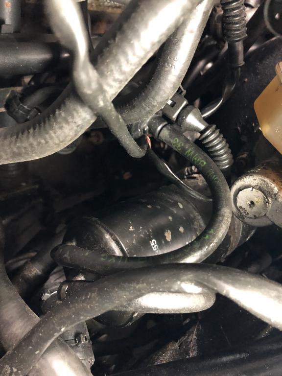

                      So it happened again. Same hose, same split. Looks like it’s rubbing on the thing in the attached picture, black and cylindrical, below the electrical connectors with the “55” on it. Don’t know what it is, some sort of vacuum operated canister attached to the brake booster. Anybody know what this is? Can’t find it on realoem.

                        That's the charcoal canister

                          Just get a replacement line and zip tie it. Make sure wherever you zip tie it doesn’t have too much heat.

                            Thanks guys! Nothing really to zip tie the return hose to to keep it out of the way of the edge of the charcoal canister. I rigged up a protective covering over that portion of the hose that comes in contact with the canister with another piece of hose attached with zip ties. Lets see how long that lasts.
                            I wonder if the poly motor mounts in my car have anything to do with this situation?

                              The electrical connectors you mention are the vacuum purge valve for the canister.
