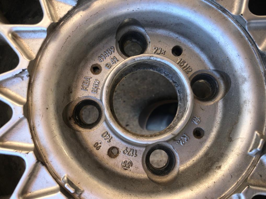

    Have a set of baskets (5) that NEED new rubber. 195/65r15 is on them now. Going to go with General AltiMax should I just go with the size that was on them or something else? 205/??R15??
    I should include these were included as an extra set when I bought the car and I haven't put them on because the rubber is so old. I'm basically going off past owners word they are indeed IX rims. Where are these marked so I can make sure they are ET41 (stock ix wheels)?
    Picture is only marks I could find but no "ET??" only and "E41" mark, is that the right one?

    That looks correct.
    The stock tire size is 205/55-15. Since tires in that size have basically disapeared, we have 195/60-15 as the closest thing to correct. 195/65-15 is oversized and may look a little weird and/or rub over big bumps/inside the fender wells (although folks have reported that it works fine).

      225/50R15 also works if you can find anything in that size, another is 205/50R15. Basically there's not much exactly the same as stock - either a little over or a little undersized.

          Those are the correct ET41 offset ix weaves.
          I run Kumho 205/55R15's as an all-season cruiser tire. That one is about all that is available for an all-season tire in the stock size.
          There are a few more choices for summer tires in the same stock size.
