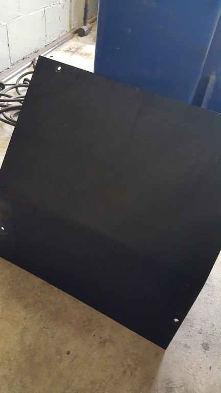

    thats the skid plate i made, i cant find any pics of it on my car, ill pick my car up tomorrow and hold it up where its supposed to go

      I'll post a pic of the car on the ground, but here's the skid plate so far. As I said, 24"x48"x1/4" 5052 aluminum plate. FYI, you are not bending this by hand.
      Made a back bar that bolts to the cab location
      Bolted on the car to see where to make the bends
      To bolt it together it goes head bolt, washer, skid plate, hockey puck, washer, 1" spacer, washer, subframe, washer, nut.
      Bent up, find a friend with access to a brake, I might end up bending the front a bit more
      Should offer some decent protection
      AWD > RWD

        Installed.
