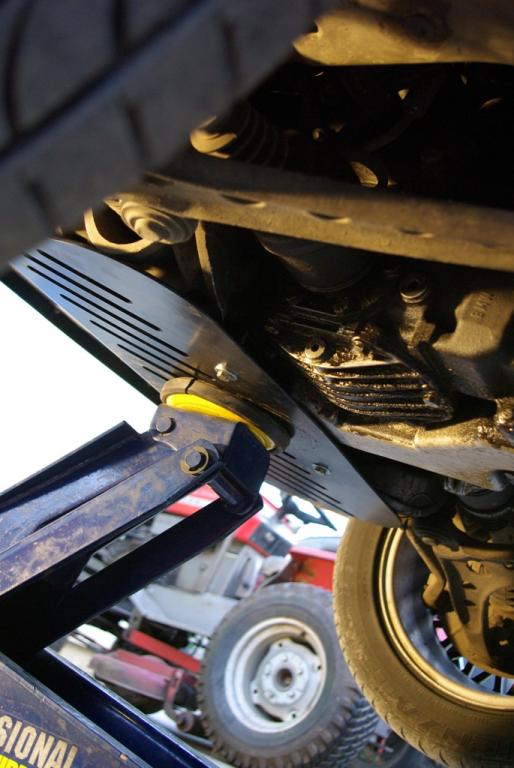

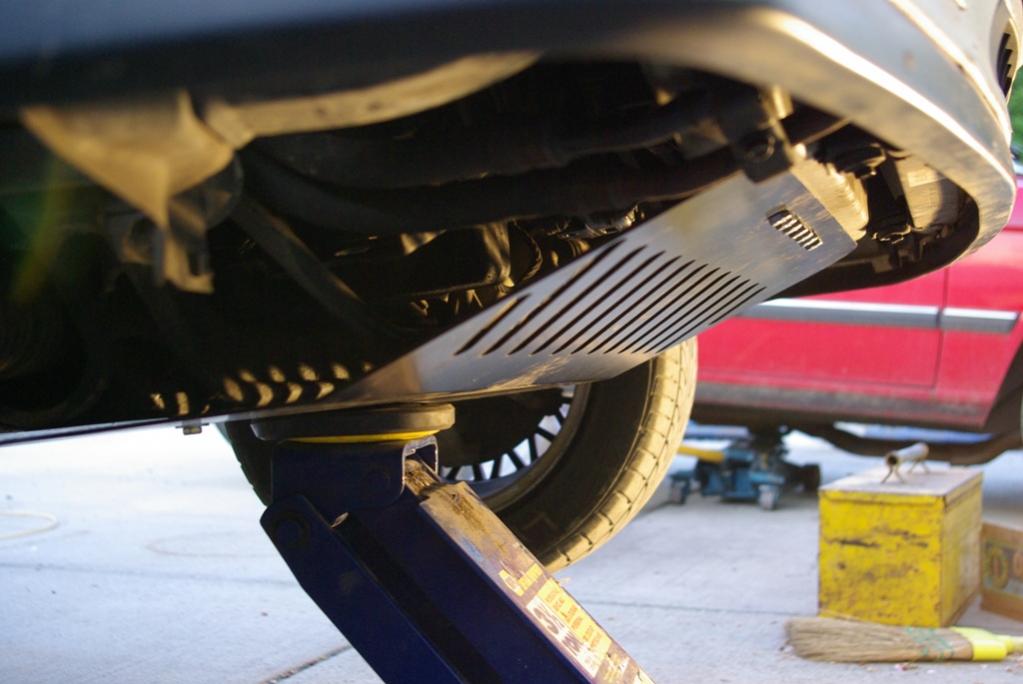

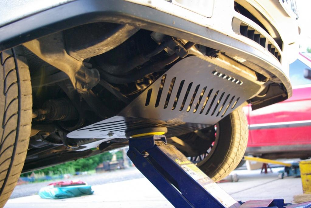

        Here is the iX plate that Eric test fitted on my car. These have been resized.
        The front crossmember is above the pad of the jack. The plate sits very close to the crossmember, and flexes to touch it when you place the jack there.
        I removed the plastic splash shield from the front because I couldn't figure out any other way to get at the back side of those 7 bolts in the front to tighten them.
        And yes, I know my front diff is leaky....

          I held one of these at the picnic, they're pretty beefy. there's a few guys that rally that would probably like one!

                I removed my plastic splash shield. The two rear bolts go through the same holes that it used in the back. Just take a look at yours, and you'll see.

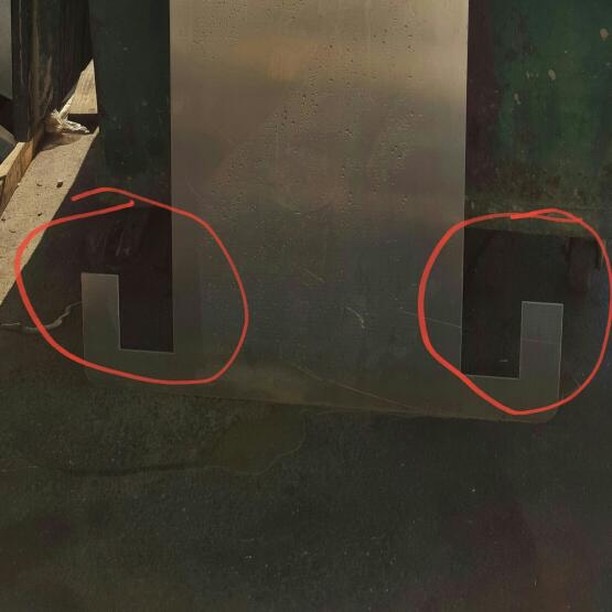

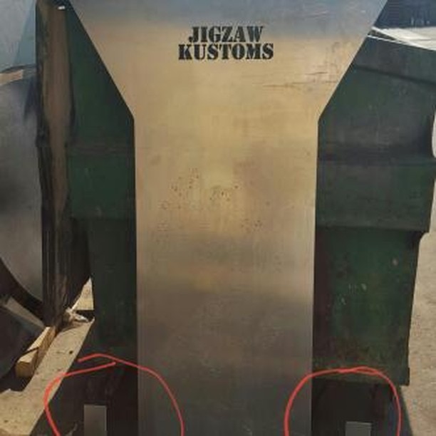

                        He said it was a pain to bend it too the shape of the frame. He drilled two holes and bolted it to the cabs. He's making a new one so this one was scraped. You get the idea though

                            Yeah I was afraid of that. I as discussing the CAB as a mounting point with a friend and disappointed with how long that will make the plate. More flex with a long plate.
