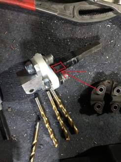

                • ForcedFirebird
                  • Feb 2007
                  • 8300
                  It's not usually the giubo that wears out, although replacing it with a plastic giubo remedies it.
                  What really wears out is the plastic bushing inside the lower half of the giubo:
Name:	steering coupler.png
                  The end of the steering column has a tapered/smaller end that fits into a bushing, after it goes through the giubo. When that bushing is worn, you can grab the knuckle while it is all assembled, and it will have lateral movement (not rotational). The rotational movement comes from the slop in that hole, which causes the giubo to bind up.
