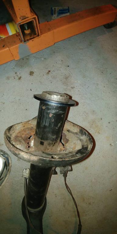

    Hey,
    I just got a 325ix, after taking it to a mechanic he found some rot on my driver side strut housing, and it's starting to crack. Has anybody ever done a rust repair on these? They seem so hard to source. Would also love to pick one up from a member if available.
    Thanks!

    It's quite common, actually. Dirt/water/snow gets trapped there. You can have that repaired with a patch, or even weld a donor perch from a RWD.

      I would also check the threaded section as it's also very common to rust. Looking at how your perch itself already has a hole...
      I've repaired my uncles ix housing with a section of a RWD tube. (I just used the threaded section)

        Thanks for the replies. I dont have a welding kit, is this something a bodyshop could do for me?

          A bodyshop probably could, but probably won't want to. You'd be better off with a welder or machinist or fabricator. Getting everything to sit straight is a slight challenge, be sure to provide the place that does yours with a strut insert so they can reference that.

            I had a machinist cut off the rusted top section off and sacrificed 2 rwd struts for their threaded sections. Then cut the spring perches off and welded in the adjustable kit from Ground Control. https://groundcontrolstore.com/products/bmw-e30-325ix I'm also using their camber plates.

              I'd bet that the best way to get a better variety of struts would be to completely remove the cup from the knuckle, add a flat section and mount a two bolt flange for something like E36 struts. That gets rid of all of the insert issues, and opens up the possibility of using more off the shelf coil over components.

                oh awesome, thanks for all the details! I found some new strut housings at a decent price, I was really tempted by coilovers but the cost was too $$$ - maybe in the future.
