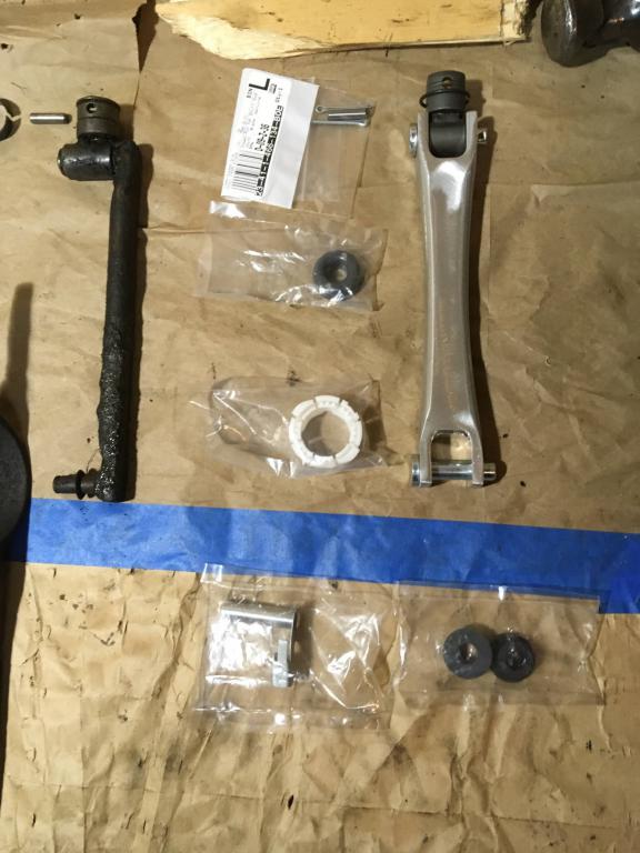

    Garagistic iX DSSR with the works including z3 short shifter (car had the z3 shifter when I bought it). Previous to this install all gears shifted precisely with the short sifter but the bushings were thrashed so the lever itself was very sloppy.
    I used this thread as motivation: https://www.r3vlimited.com/board/for...le-broke/page2
    And triple checked the orientation of the shifter itself, seems to be correct. At first I thought maybe I installed it backwards, Bentley manual and the photo in this thread above confirms I believe it is in there with the correct orientation. Seems like I am not fully engaging 2nd and 4th. Does not pop out under load, difficult to engage though, particularly 2nd.
    1, 3, 5 feel like shredding the Nürburgring in a DTM E30 M3 circa 1990 (ok, ok dogleg in the M3s, semantics really...), and no problem finding R. 2 and 4 feel like shoving a stick into a bucket of marbles. Thoughts? Someone tell me I have to drop the subframe, transmission and get all the way back in there... so I just go do it. Thanks for any input or experience here

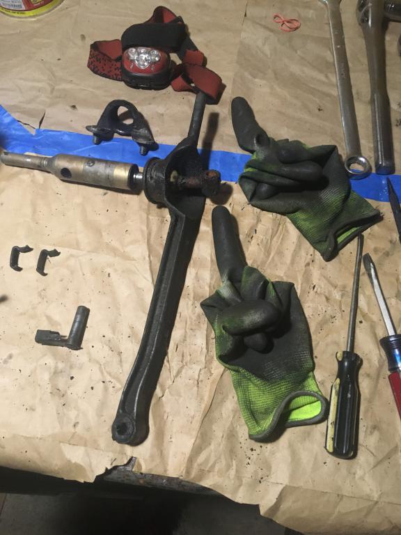

    and some humorous photos of the shifter swap:
    Click image for larger version  Name:	ACtC-3eEKvMaJCTQr945-IhNVo7Z5PLYQ8BE5M7mPRefkp7E4Z0G-nz1ZaKlhfxBbNKMSrnV4Cb5FXIV52njkkVFUjrz-uvtR_6_R68PEKA17t_YzVsm3qT6hxvxvXj_eU5OKKDOdQRy0lvKjUe1sAqKibhk=w1552-h2068-no?authuser=0.jpg Views:	0 Size:	63.6 KB ID:	9966446
    Click image for larger version  Name:	ACtC-3fhKk9t05c17dIYIXUT9vtgJ5lOOqd_U3fzXwIIkeX4m3IWzyDNVImu2lq7I2CbxI7Q9x9DQNblBSX8MHWynoqDcR8isAEhro4OYzeAII7I8RF9enGM23ik3VQJlVcqjRXDbpjTtIyxX8LulwfmnKbB=w1552-h2068-no?authuser=0.jpg Views:	0 Size:	60.8 KB ID:	9966447

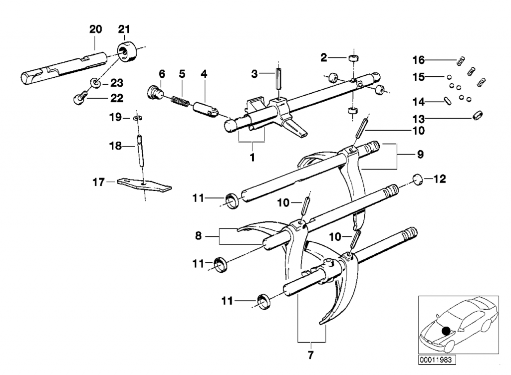

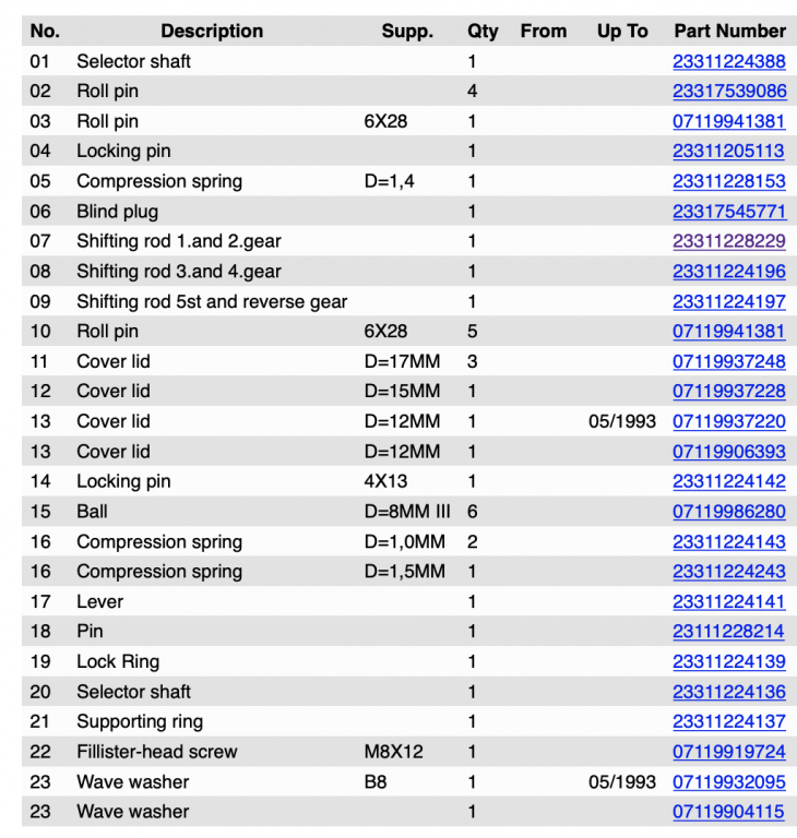

                One thing that is bugging me... I failed to measure the DSSR length compared to the stock selector rod (to borrow a phrase from Mr. Red Forman... dumbass). This was on my list to do prior to confirm fitment, but slipped my mind as I went for the install
                So, the 2 and 4 gear selection are both "down" toward the rear of the car obviously, with in turn becomes a "push" of the selector shaft into the transmission. If the DSSR was too short (ie. not shipped to me as requested iX specific) this could cause the selector shaft to not be completely doing its job? I do not know enough about the inner workings of transmissions to be even remotely knowledgable here. What I do know is the iX selector rod is 3mm longer than the RWD E30s... so this could be my issue.
                Getrag gurus needed. Also awaiting the mythical Mr. iX to appear with wisdom ​
                Click image for larger version  Name:	ACtC-3esXygBmlGNZusSo9SY0I3Qxsjbdy1N1JBepeW3S96FR3qUC3TJEKlLXu3YkSC9--X1ud38UPLySWYz7_IX11VBxpOBh5p2RQcJtu1VpsiQ3giDbCqwR6qZutEXxvsN2Og3vX1hv_3Gv3xZFUwUwklI=w1312-h964-no?authuser=0.png Views:	0 Size:	211.2 KB ID:	9967125
                Click image for larger version  Name:	ACtC-3eD8ru9lSaJkMM9HGPVlWpjyVwB1LIeG4SvFGYUHh3H8tDJEQwhbdVIs_13FAoThjYM-5CFLP9cikRpmsHH4xnh3oRdh6FRiePCuvBOK-QnaNQ4KNi794CtufiFI-TYw7jGOnxu2LgGe6rlr-wl45fj=w1024-h1078-no?authuser=0.png Views:	0 Size:	351.1 KB ID:	9967126
                At this point I need to go in there and measure to put this theory to the test. Anyone want to get a pool going on the length of my installed DSSR? $5 buy in

                  Isn't the length just for the position of the shifter knob? Shorter/longer DSSR will only "rotate" the shifter more forward or backwards.
                  I don't think it's influencing the shifting motion of the gearbox.
