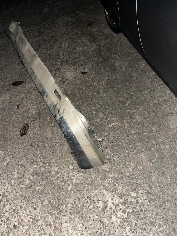

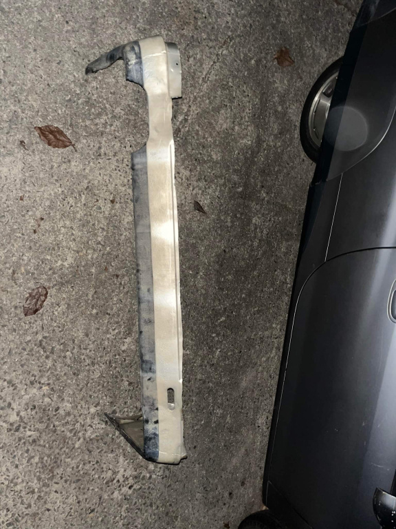

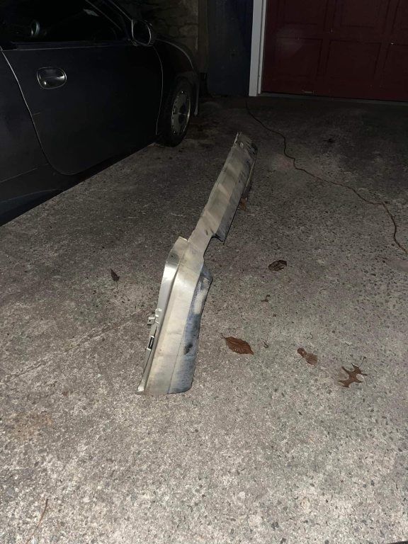

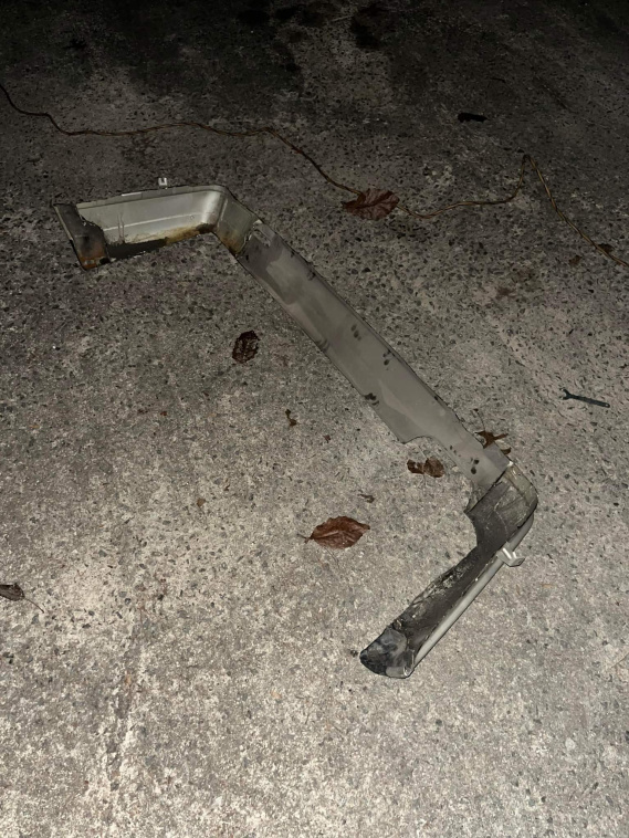

    Hi everyone.
    I recently got my hands on a late model REAR lower valance cutout and was looking to retrofit this onto my early model coupe.
    I browsed through a few threads on this forum and read that a few people were successful in using adhesive to glue it over the existing lower panel without having to cut and weld.
    Unfortunately those threads are quite old and the photos attached no longer work.
    Does anyone have any photos and or tips on how they installed it?
    I can most likely figure it out once I mock it up but would appreciate and advice/tips in advance.
    Thanks!
    Freddy
