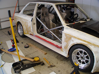

              What made me laugh was all the ignorant comments, people really want to say something even if they don't know what they are talking about.
              FG work is tedious man, it takes time and effort to get it looking good. The nice thing is that you can rough it in as you go along, the foam is fine for a plug. I think you'll be happier as you keep going, like you said the FG is easier to get right than that soft foam. Just keep layering, sanding, filling until you get a nice strong shape with smooth surface. You could look into using rivets or Dzus bolts to adhere the panels to the body. I give you credit for trying man, most people won't even attempt something like this, then again they don't usually have 350hp and custom widebody kits..... Good luck and keep us posted.

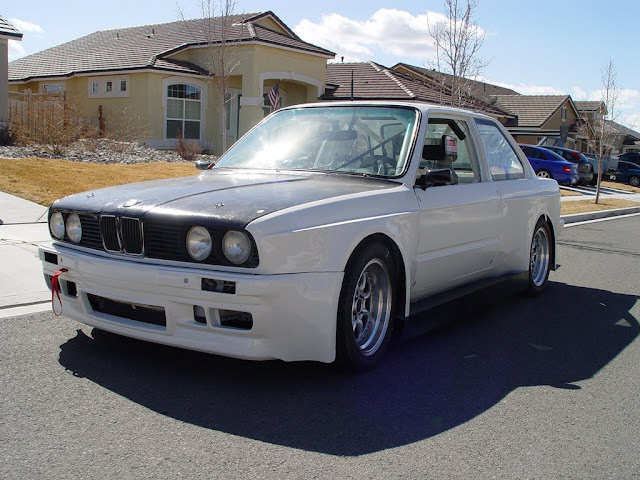

                Ok, the idea is there but I think the process used is...awkward and time consuming. LOL @ people that think you're going to rock foam fenders though haha!
                Here's a blog I ran across with some of the best DIY fab work on an e30 I've ever seen. Highly informative...
                http://projecte30.blogspot.com

                  That car has been posted here before. Pretty awesome stuff.

                    That's awesome, there is a big advantage when using fleece to form the contours compared to building a plug from foam or clay. Both will work, just takes soo much longer to do with foam.
                    Checkout some fiberglass forums, there's a ton of info to be found and those boards tend to be a bit more responsive to this sort of thing.

                            The guy with the car posted above used spandex, not fleece. Fleece would leave a pretty rough surface that would need a lot of sanding to be able to pull a mold off of it. It's better left for building solid object like speaker boxes and such.

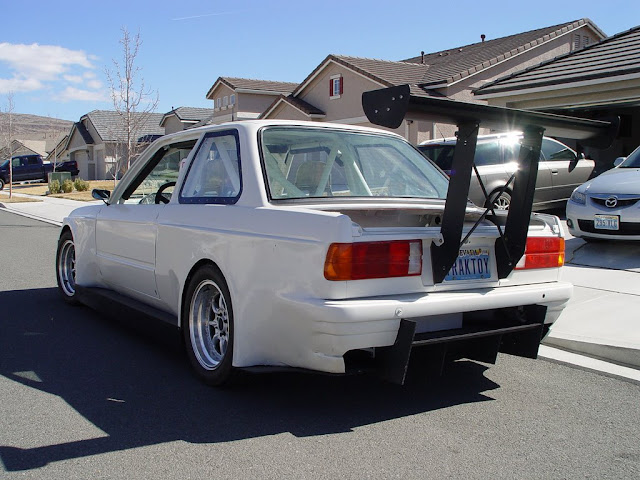

                              That looks great! I love race/track cars with huge flares. :up:

                                I like box flares and widebody myself. I think you should try and do the front a lil better. And use a satin color, because the one posted above looks plasticy too me. Just my 2 cents anyway.
