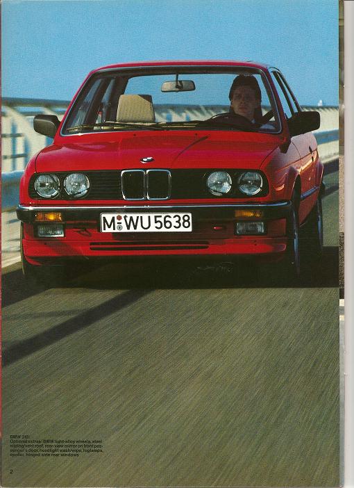

                  ok got ya. Well what valence/air dam came on the 325is with euro bumbers? And did they have an apron?

                    No they didn't have an rear apron. And here is the lip, it's kind of hard to see at the angle that it's in the picture but it kicks out in the front, but the stock 86-87 e and i lip will work on it also.

                      oh i can reuse my stock is lip? Nice And as for a rear apron.. Our cars dont have one but can i get one because i like the look and i would need it to cover the old bumber shock holes.. that you can see with the euro converserion in the rear

                        The iS lip/valance with euro bumpers http://www.r3vlimited.com/board/show...32&postcount=7
