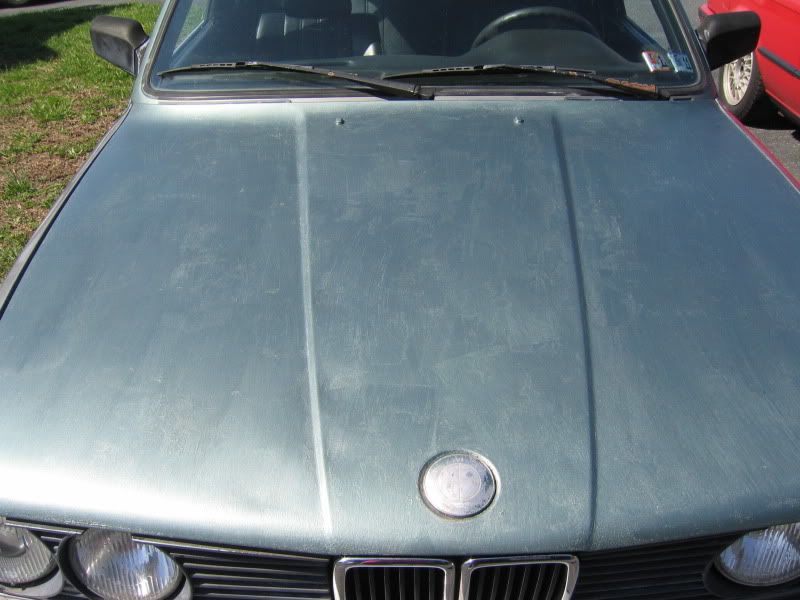

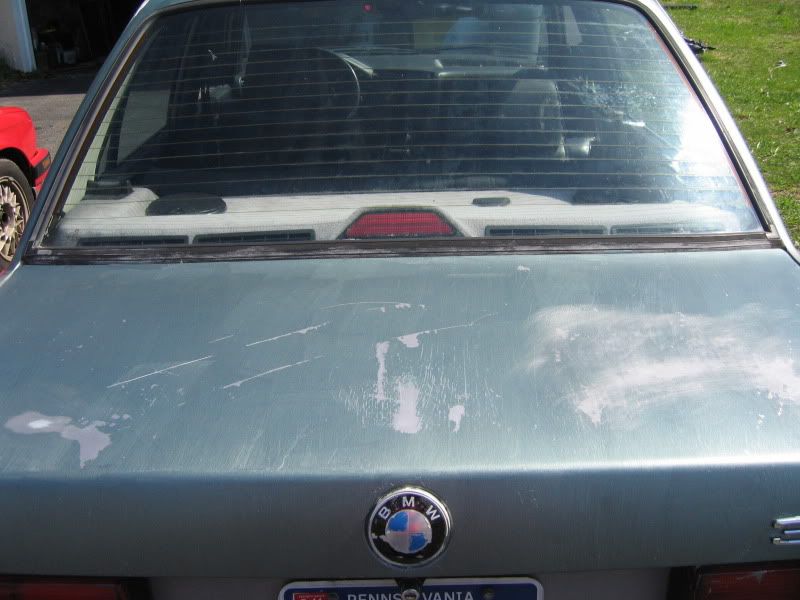

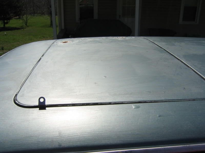

            It's a beater so im trying to go the cheapest route that will look the best, my ideal solution is to get the house paint off and just have the existing paint polished, won't be great but it will be better than it is now. Here's some pics u can see what im messing with:
            Sometime in the next few weeks i'll start messing with the paint. For now i gotta do some maintenance first, then worry about the cosmetics later.

                  It looks like ass, but i can scratch it off with my fingernail. Thank god the previous owner wasn't smart enough to sand the car before applying house paint! Post up some pics of yours, im curious how it looks
