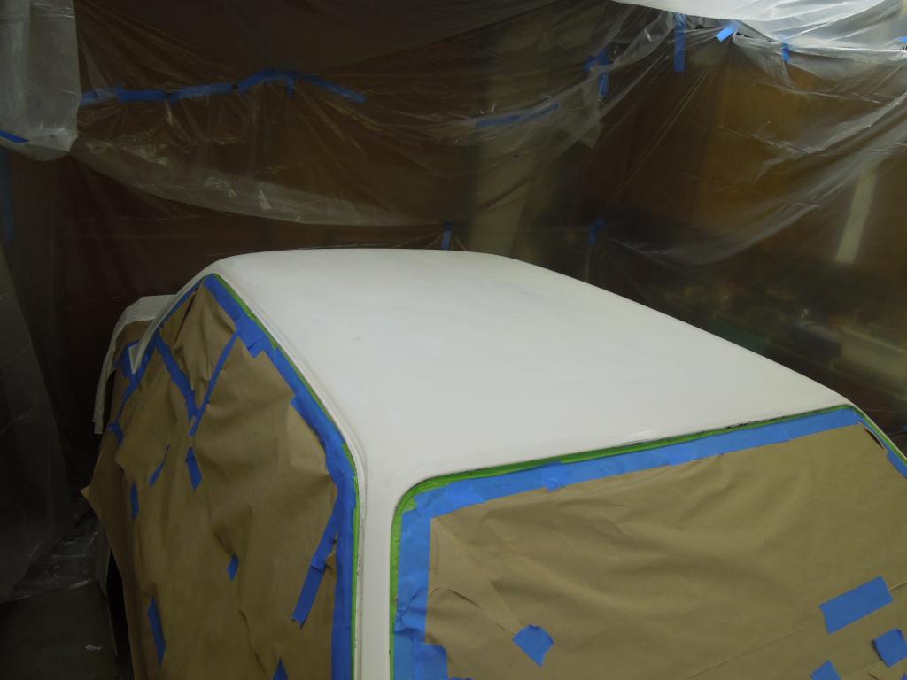

                        I just shot my roof after removing the sunroof. Used single stage catalyzed poly (no clear) with a Harbor Freight HVLP.
                        Here's what I found:
                        - Practice on other panels before shooting body panels. The car shouldn't be the first thing you do because you will learn what works for air pressure and setup.
                        - Use guidecoat. Car will look great until you spray with guidecoat and sand, then you'll see how hosed it really is and where it still needs work.
                        - Must have a filter before the gun to capture moisture! It's raining inside your compressor.
                        - Get the best respirator you can find, if not forced air.
                        - Bugs and dust will find your fresh paint, if you let them.
                        My roof looked Ok for the first several days, then I color sanded and it looks amazing.

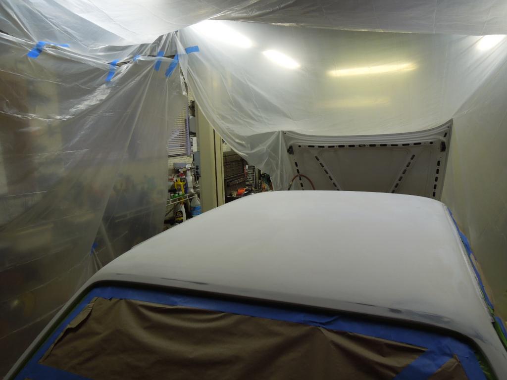

                            Here's the "during"..
                            I'll need to find some pictures of the result.
