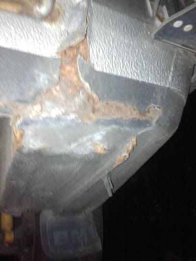

              This is the undercarriage rust and the rear valence. Not pictured are the rockers, rear wheel arches, wheel well, and the minor stuff around the trunk and tails...and God only knows what else, at this point. Worth getting out of the car and finding a straight one?
                Its a PA car, you'll probably keep finding more and more rust as you tare into the car.

                    It's not the end of the world. I've seen a couple rot repairs on various e30 forums done with fiberglass by people who don't have access to a welder or have the desire to cut and weld.
                    Plus, you could always drive it while looking for a clean body.

                      You've got years left on that car even if you don't touch the rust.
                      No E30 Club
                        Also it's not in the rust belt anymore so I hope that even if I don't fix it properly some POR15 will essentially stop it.
                          That is not that bad. If you are really afraid of rust repair, you can POR-15 it, but that rot is not that bad. Just get a grinder, grind it out, and hit it with some rusty metal primer.

                            just dont fix it. just rock it as a DD and be happy.
                            and continue to look for a super clean e30.
                              Could I do that with a Dremel? I don't have air tools.
                              This may be a more realistic approach in reality. I'm going to try to fix a couple of lil' spots, but if that goes poorly I might say :wgaf:
