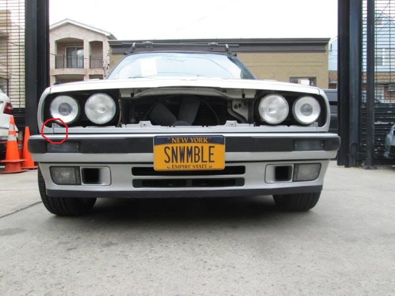

                    here you can barely see the gap difference between the pass and drivers. Passenger side is the aftermarket fender. Up close, it doesn't fit snug over the thin area below the headlight. Also has a weird indentation. The OEM drivers fender fits as it should.

                      I got aftermarket fenders when I did my car and I think it was a big mistake. If I did it again I would go with used oem. But sometimes you get lucky with them those aftermarket ones, in my hand I didn't haha. I think they were from eBay or something.

                        OEM fenders are hard to find in good shape up here, and people don't like being hassled with shipping large items.
                        So if the above pictures are of a rock auto fender, for 50 bucks thats hard to beat!
