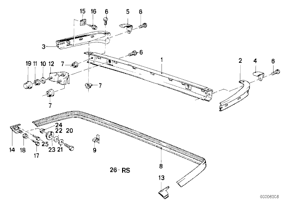

    I've removed the rear diving board and I'm about ready to install the rear euro bumper, but the bracket I have doesn't seem right. Even though it's the correct part number. #12 Bracket 51121916597. The holes on my car are wider than the bracket bolts, I'm stumped.

    I havent dont this but a quick goggle search gave me this

      Ok thanks. Looks like I have to drill a couple holes.

        here's the DIY thread

          Drill 2 holes. There are dimples that mark the spot.

            Sweet, I think I got them figured out. Can't wait to get the mtech 1 rear valance now to clean it up. Another question I have is there an installation kit anywhere for the rear mtech 1 valance? I see that bmw doesn't make one anymore. Or could I just try and have a body shop try to fabricate a way to install it? Then to try and find the impossible front. Jessh!

              http://realoem.com/bmw/showparts.do?...79&hg=51&fg=15
              Looks like BMW still has most of it.

                  Sorry, 51121932244 which is the install kit is NLA.

                    Scroll down the list and it shows "most" of the parts are there... You'll have to piece it together.

                          You're right Jason. Everything is till in the states except for the part number ending in 905, which will have to come from Germany.
