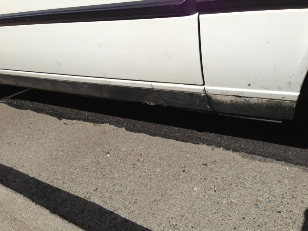

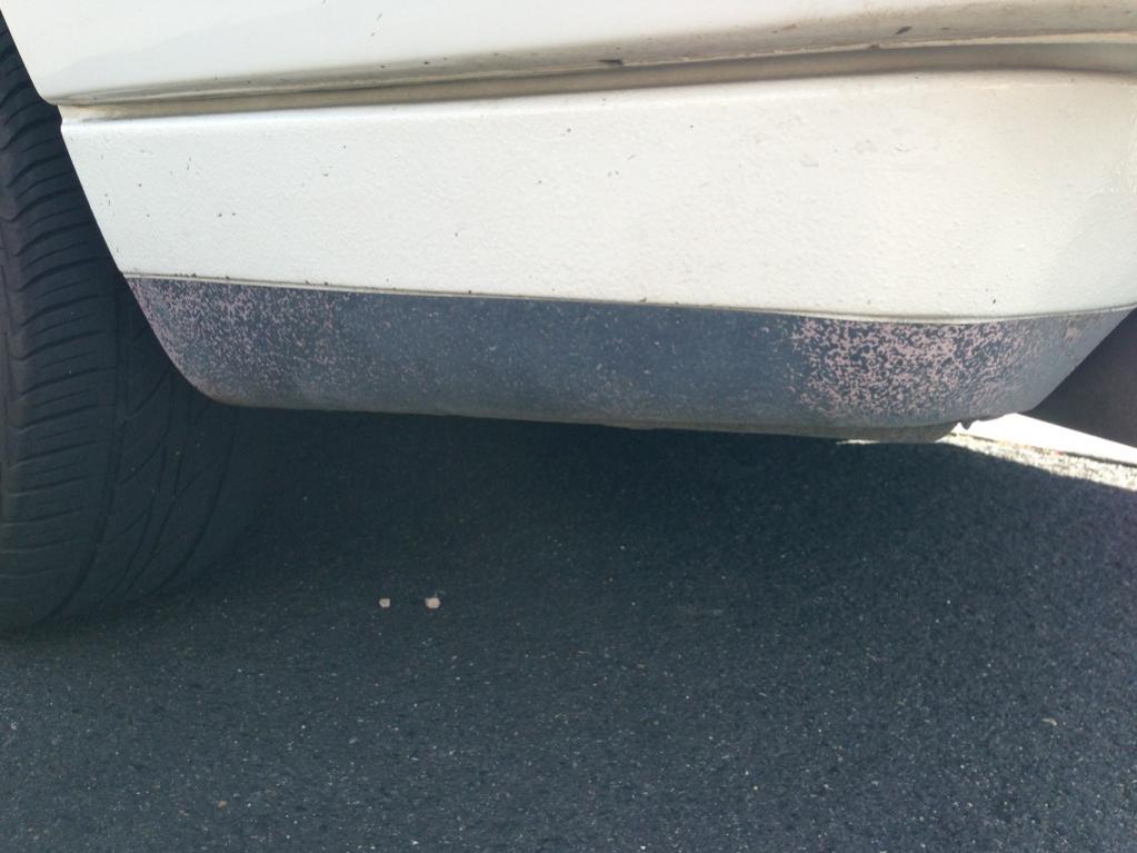

    Rocker panel paint?
    So do you guys usually just repaint this black or can it just be scrubbed off and left alone? What've you done?

  • ak-
    • 12422
    I used rubberized undercoating I think.
    1991 325iS turbo
    • als88
      • Nov 2011
      • 160
      Did you take off the original coating first?
      • ak-
        • 12422
        No, that shit needs an angle grinder. The original coating is more rigid.
        The stuff needed quite a bit of time to dry though. Sprays on looking brown, but turned black in time.

          • jeffnhiscars
            • Jun 2011
            • 6010
            My rockers looked pretty much like yours. I gave them a good cleaning then refinished with SEM Chip Guard in satin black (#39813) and it came out great. Oreilly brought a can in for me as they didnt have it in stock and it was about $25.

              • AndrewBird
                The Mad Scientist
                • 11898
                I've seen people use spray on bedliner as well. Paint would work fine though, just more likely to chip. Rubber doesn't really chip. lol
                • CW325
                  • Jul 2011
                  • 1434
                  I rolled on some rustoleum, it came out good.
                  • audiquattrot
                    • May 2008
                    • 3836
                    i used etched primer, followed by Duplicolor Trim paint. Came out just like OEM.

                    • als88
                      • Nov 2011
                      • 160
                      Do they come off? Or do you guys just tape off the rest of the car?
                      • bimmer2288
                        • Feb 2006
                        • 273
                        I don't think they come off. I'd suggest taping and masking with newspaper or painter tarp
                        • littlehandegan
                          • Apr 2015
                          • 64
                          I am about to tackle this job on my newly aquired E30.
                          It looks like the options are spraying, or rolling it on. Rustoleum brushed and rolled is obviously the cheapest.
                          Anyone have any input/reviews on what they used?

                            • Stanley Rockafella
                              • Aug 2011
                              • 4056
                              I rollered on some undercoating on the rockers. Left on the original stuff and just supplemented with the new stuff. Came out matt black and REALLY clean lookin. No need for taping off etc.
