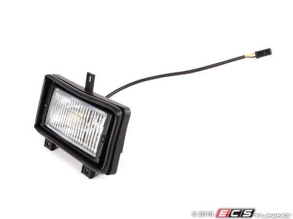

rear view of the left side euro fog on a 770 valance. You can see the part numbers on it
UPDATE: the part numbers molded into the back are for the bare housing, not the assembly. You won't find them on realoem unfortunately.

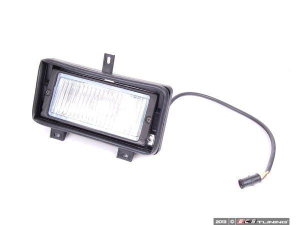

here's the right side euro fog assembly
NOTE: This is the correct setup for a PLAIN euro front end car with fogs. CHECK WITH KRONUS AND RAUL FIRST. Not sure if the Alpina setup is different.Last edited by bradnic; 09-18-2014, 12:31 PM.I BUY/SELL REFURBISHED CM5907s & CM5908s

no that's a pre-9/85 fog - check the realoem listing comments.i found this 63171374893, is the correct one? There seems to be two kinds!
http://realoem.com/bmw/partgrp.do?mo...63&hg=63&fg=15
since I confused you, here are the fog assembly listings I know about. They are for late 85-87 euro cars - there's pre-9/85 original, 9/85-87 (redesigned frontend, but STILL pre-facelift), and post 87 (plastic bumpers)
http://realoem.com/bmw/showparts.do?...63&fg=15&hl=10
left assembly 63171376935
right assembly 63171376936
you should still confirm there is nothing special about an Alpina 147 foglight setup over a basic euro fog setup.I BUY/SELL REFURBISHED CM5907s & CM5908s
