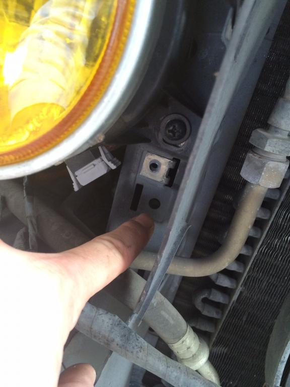

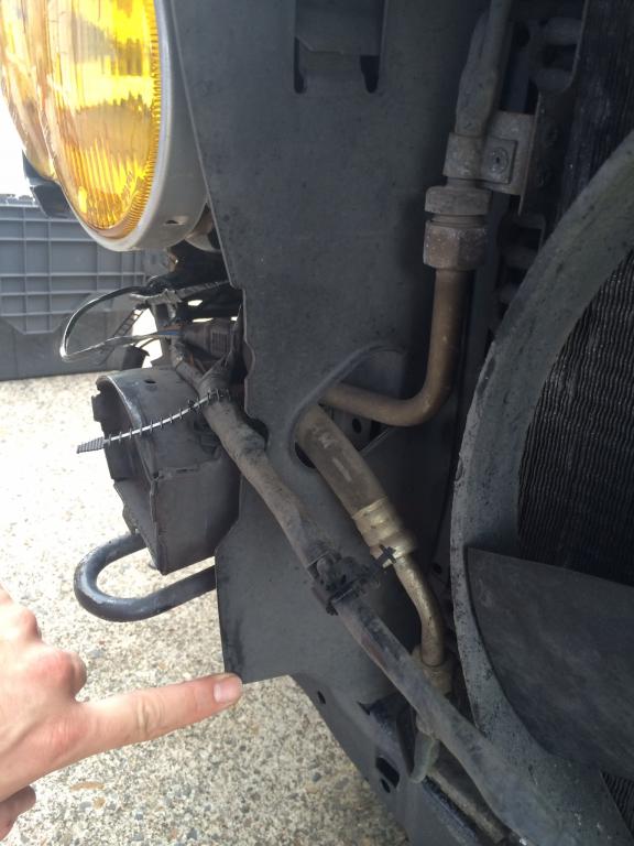

                        Mine is a 5/86 build car. You have to trim the plastic radiator shrouds at the bottom to use this valence, and the upper mount points are moved down to the lower slot.
                        I can take pictures if you like.

                            This is the section you cut off, about 3 inches long from point to point.

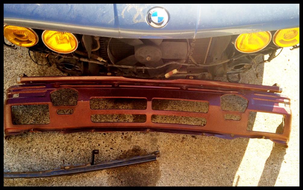

                              This is the upper mounting location. If you use the early upper strip, I believe you have to use the lower holes. I cut my us valence and am using that as the upper piece. You have to reshape quite a few little spots if you do it this way. I'm only doing it as the euro upper I got was pretty trashed and rusty.
                              I lucked out as a friend local had this euro valence and wasn't using it.
