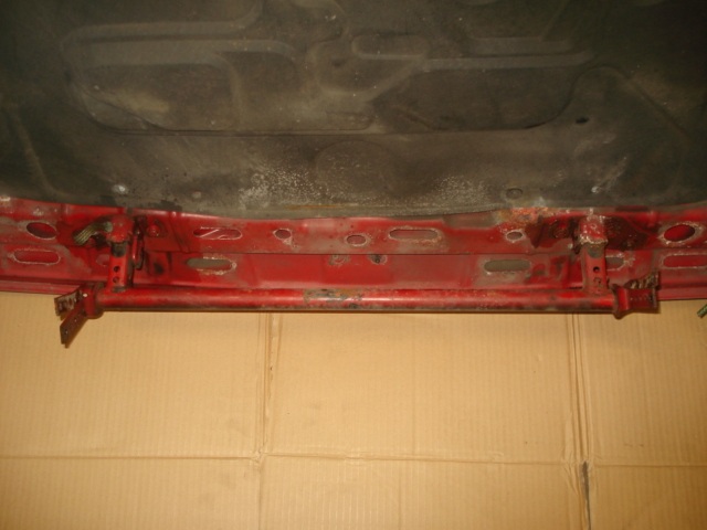

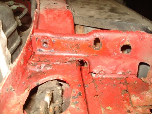

    Take the hinges off the car. The torsion springs are very weak, they will not fight you. It's completely unnecessary to remove those six bolts. No more trouble lining this back up and it's now a one person job because once the four bolts are loose, the entire assembly just rests on the core support. Then pull the pin on the support hinge, walk around to the front of the car and lift the hood off. And now you don't have to deal with the hinges in your way when reaching into the engine bay.

    Not sure what you discovered here...but I do know your car is dirty rusty
    • Andy.B
      • Sep 2011
      • 1650
      Welcome to the rust belt. That's a relatively clean e30 around here.
