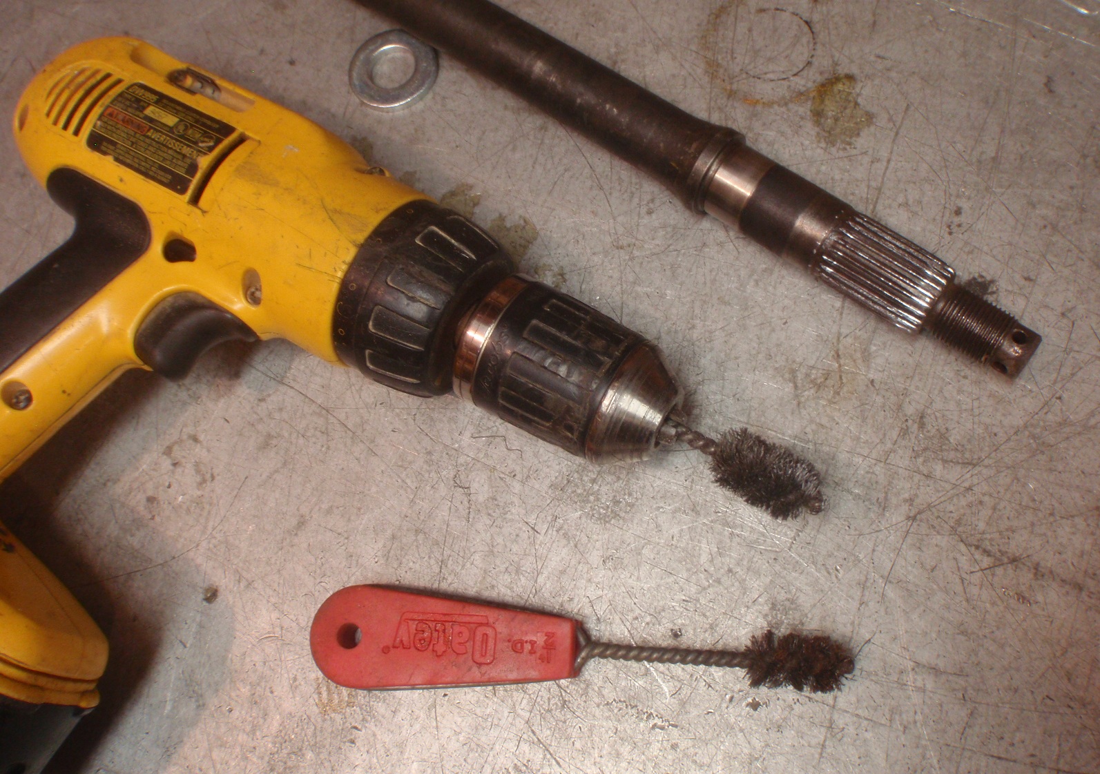

                Steam and simple green worked to at least loosen some of it. The best thing I have found so far for removing it from non painted surfaces was this, the little red thing on bottom, and a little screw driver.
