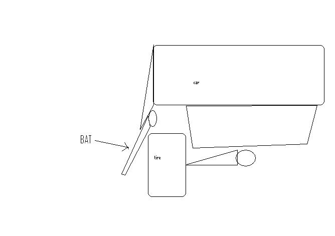

      Something like this for the bat, excuse the ms paint (I have zero computer drawing talent):

        I've tried the bat method, I don't get how that could ever work. for one, there's only about 1/4" between my tire and the fender, and second the metal is stiff as hell. I ended up using a sledgehammer, but I have the fender skirts covering the lips so I don't have to worry about chipped paint or wavy edges. if it were me and I had a 325i, I'd definitely try to track down a fender roller and do it right.

              baseball bat works...u have to jack up the car, the put the bat between the fender and the tire, then lower the jack just enough so that there is some weight on the bat, then roll the bat along the fender..VIOLA.
