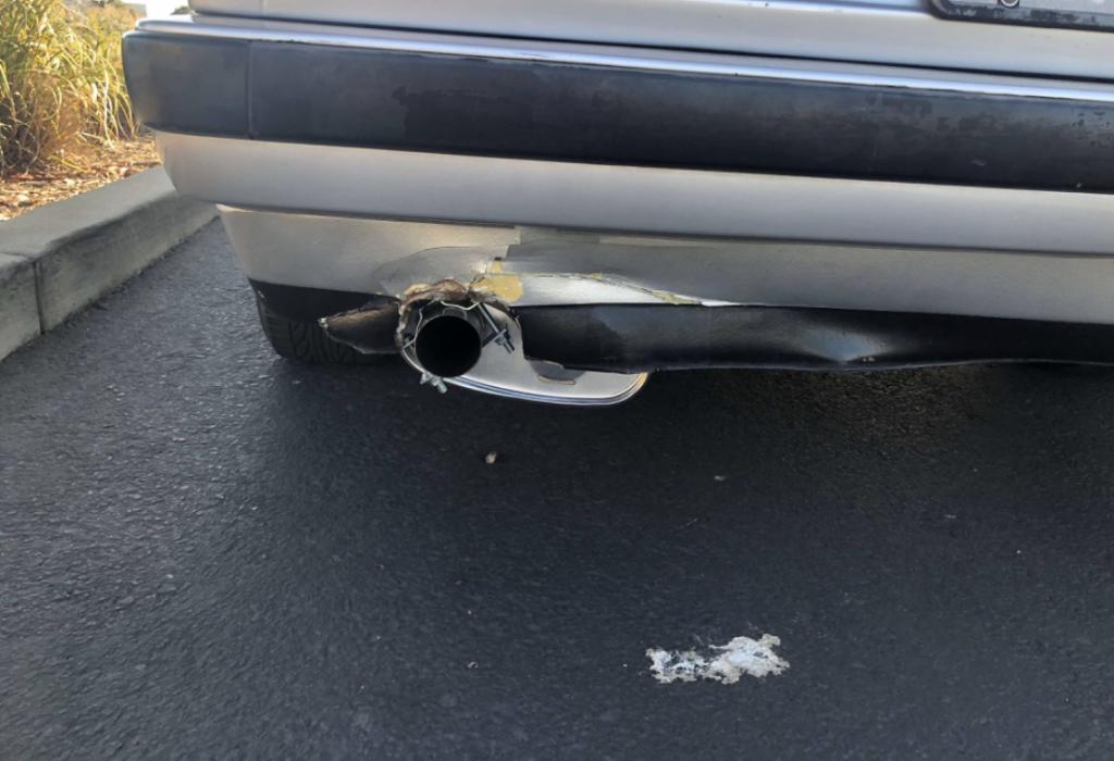

    hey there,
    I recently got an e30, everything is good except for this “mod” a previous owner did to get a muffler and exhaust tip to fit.... how do I fix this? Im not even sure what to google...

          I mean what’s the name of the price that’s fucked up lol. So I can maybe find a replacement

            rear valance

              The rear valance is a core component of the overall car, and isn't simply bolted on. A body shop, or someone with those types of skills will be required to straighten that out. After the exhaust is redone of course.

                Looks like the valence was made of bondo anyways. You're looking at a whole new tail panel unless you're fine with a bodyshop repairing it with bondo again.

                    Not sure about that, there's a thick protective coating on the rear valence and I think that's what you're looking at.
                    I'd take it to bare metal and let a guy go at it with a hammer and dolly. Probably your best bet there.

                        do you mean just have a guy repair the current valance?
                              Yes. A good metal shaper/body guy should be able to do it.
