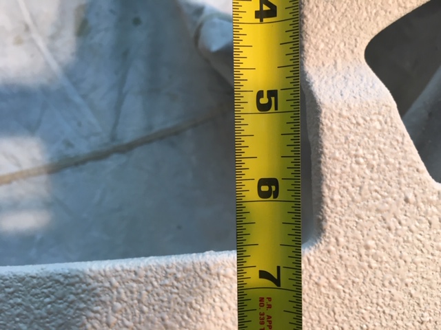

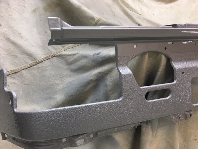

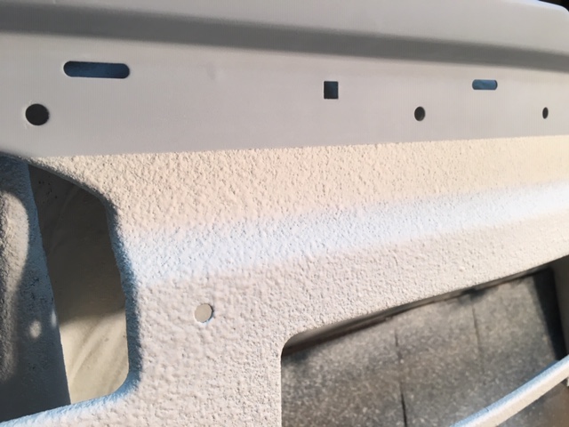

                    I picked up some 3M Rocker Schutz and prepared the panel, now I need some warmer weather.
                    Next question, after applying the 3M Rocker Schutz should I use some primer to even out the color before spraying the final color coat?
                    2004 525i Manual - 1985 325E Coupe Manual
                    • tomstin
                      • Mar 2015
                      • 570
                      Thanks all for the help. I often get frustrated with people that don't update or close their thread with a solution so here goes!
                      I stripped the panel to steel, a few coats of Eastwood 2K Epoxy primer and sanded. Used the beige Rocker Schultz @ 45 PSI, 3 passes seemed about right. To even out the color, another coat of the Epoxy primer. Then a few coats of PaintScratch rattle can. Finally, a few coats of Eastwood 2K clear.
                      Painting at this level is new to me and I did learn that EVERYTHING shows in the paint. Lesson learned, but I'm happy with the result.
