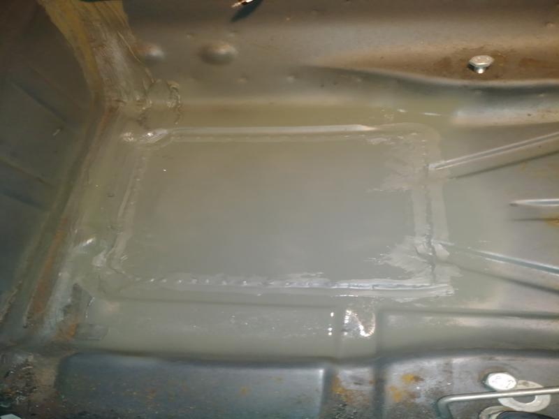

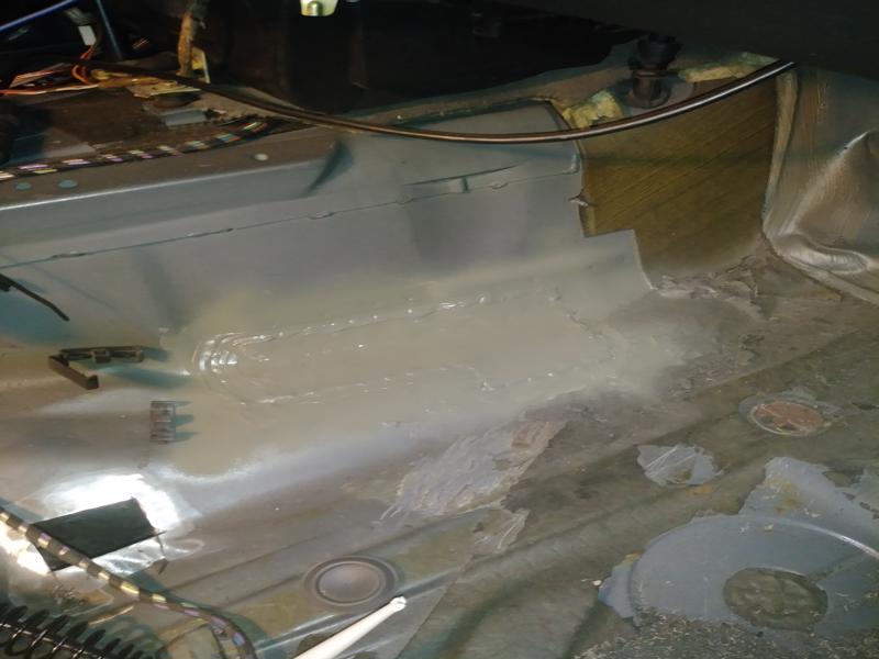

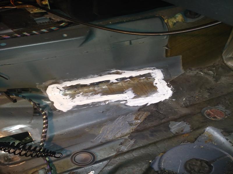

    the hole on the right looks innocent enough, but this is the area that connects the trans mounts, underneath the surface the metal is soaked with oil and road debris. I cut back the inner layer to reveal very minor rust, I will not be drilling out the plug welds for the tranny mount at this time but will keep an eye on it

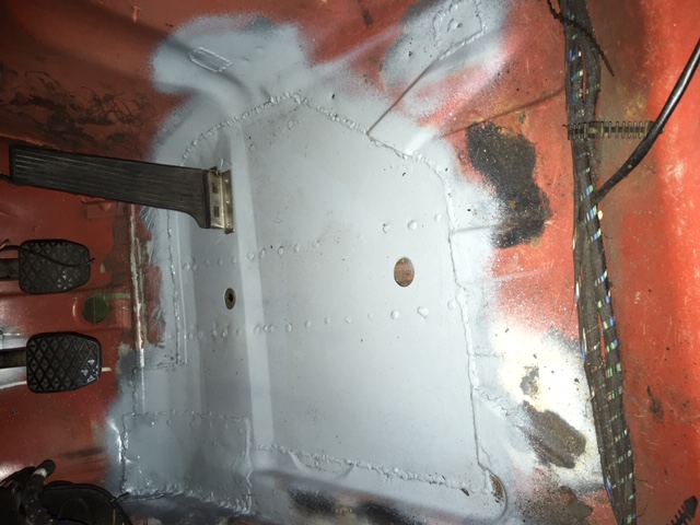

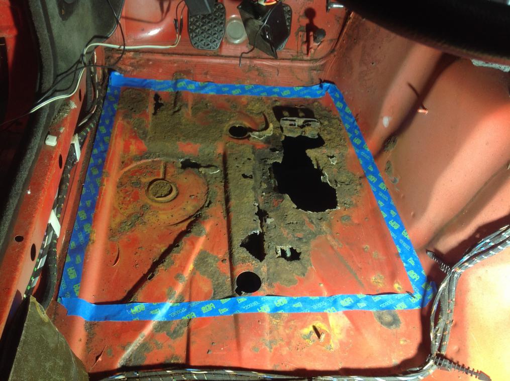

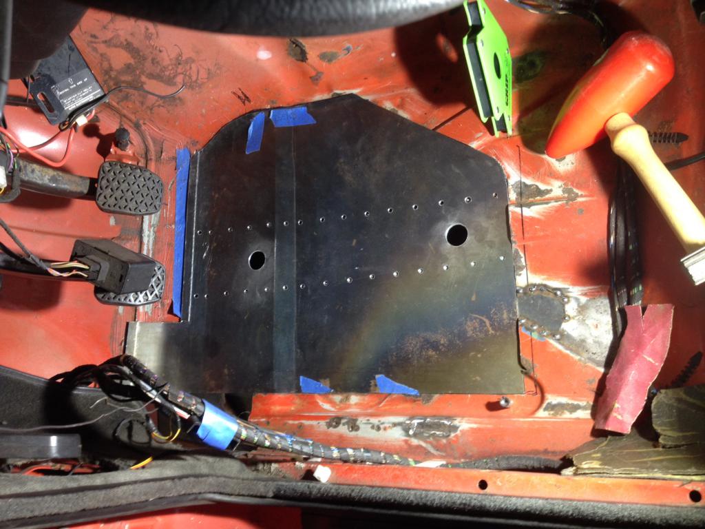

      Here is my Fred Flintstone floor.
      • Sunnyledge
        • Nov 2017
        • 221
        New Hampshire can be tough on BMWs. 18 ga patch fabricated.
        • Sunnyledge
          • Nov 2017
          • 221
          And welded in place.

                  18 ga. cold roll. I had to anneal the panel so I could shape it and create the curve at the base of the transmission tunnel.

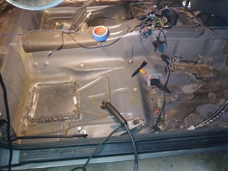

                      I gotta say, after seeing what other people are dealing with as far as rust its given me some decent motivation to get this done. spent a couple hours cutting and tapping the trans tunnel area patch back in after work last night. I think it turned out very well.

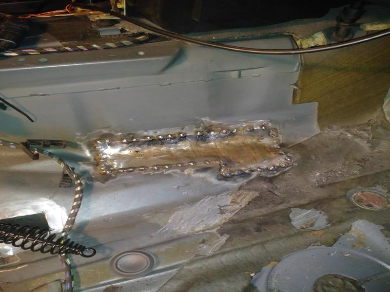

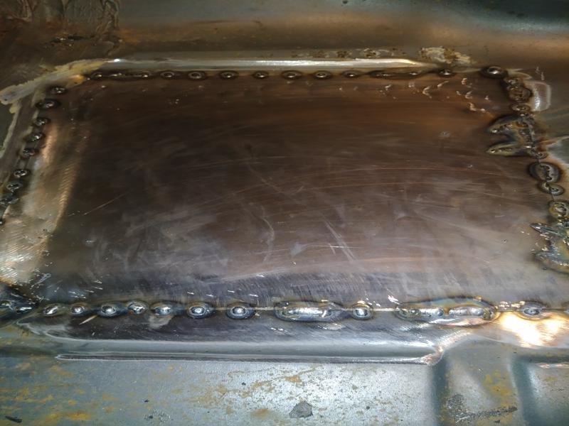

                        Not in order but got two more patches done sealed and primed today. still un decided on what im going to do for final seal inside but the bottom of the car will get wire wheeled, fiber-glassed and then rubber undercoating. making progress.
