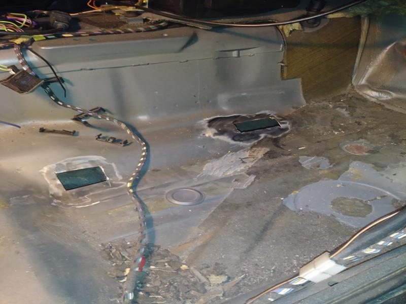

    rusted floors, how bad is it?
    well, not what I was expecting to find when I removed the carpet. someone covered it with fiberglass and hid it from the outside with rubber undercoating???

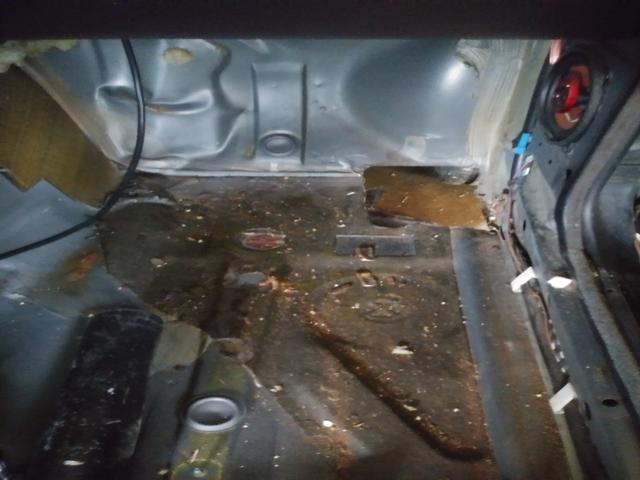

    and the passenger side..... same problem

      I can't really see much in your photos. If it's rusted, wire wheel it and see what you've got left.
      • turbski
        • Jul 2018
        • 329
        ya photo quality was junk, look closer though. there is nothing to wire wheel. the large bright spots are my garage floor.
        • rturbo 930
          • Dec 2005
          • 2616
          Oh, someone already cut the rust out. Alright. Well basically you're gonna have to make up some patches and weld them in.
          • SethB
            • Feb 2015
            • 88
            I've seen way worse than that patched up. It seems almost inevitable on our cars that those outside corners have some level of rust, those don't look too bad. A couple of pieces of 18 gauge steel cut and bent to match those holes should be pretty easy to weld. Then primer and seam sealer, undercoating on the outside, and you'll be in pretty good shape.

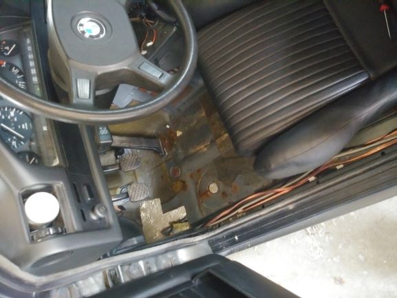

                Turbski, here are some pics for encouragement. The first is from when I pulled up the carpets in my ix for the first time and wanted to cry. The 2nd is after they were all patched up. It's time-consuming work, but completely do-able if you've got an angle grinder and a mig welder.

                  The part I'm having trouble fixing is where it connects to the inner cab. Its a hard angle with a slight radius. I got the passenger side done today and will post up tomorrow. Will try to keep this documented as I go.

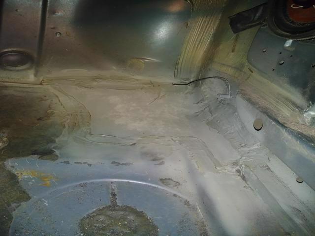

                        Found 2 more while prepping last night. Entire rear drain pass side is toast and 1 more small hole in pass side trans* tunnel area. Dropped heat shield and exhaust. Works out ok though I want to add a resonator while exhaust is off. 3in straight pipe to a vibrant muffler is to much for my taste

                            The rust really isn't all that horrific. More of a PITA. The first patch was down and dirty. tacked, Tapped gently into shape with a Big f*ckn hammer, tacked again, seam sealed. Not pretty but sturdy. Im not a stranger to welding by any means. BUT.... this is my first e30.
