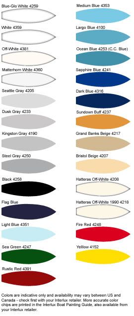

                                another impressive pic from aussie driver using Brightside marine paint. After wetsand and polish:
                                Those of you wondering about colors...here's the colors available for Interlux's Brightside:
