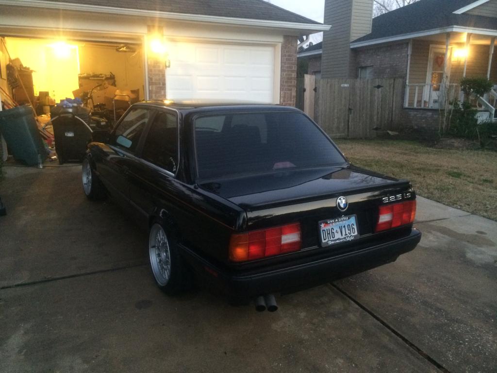

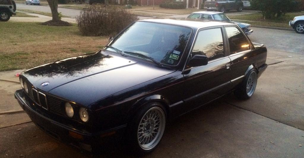

    e30 buffed and polished today
ID:	7164179clayed than cut with meguiars, than finished with 3m ultrafine polish and zaino
