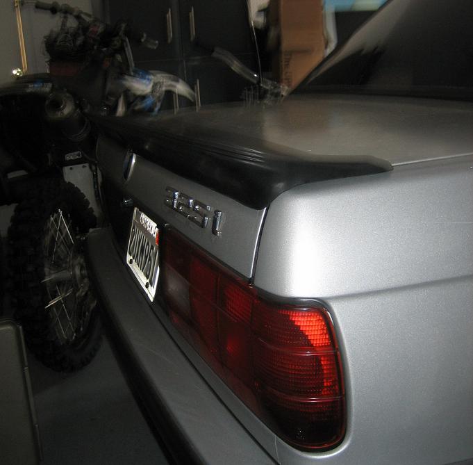

      e28. sorry for the blur but got mine pretty flush

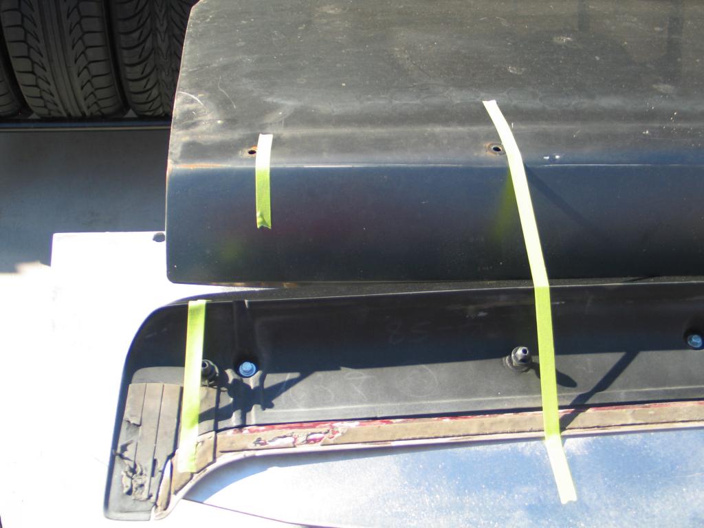

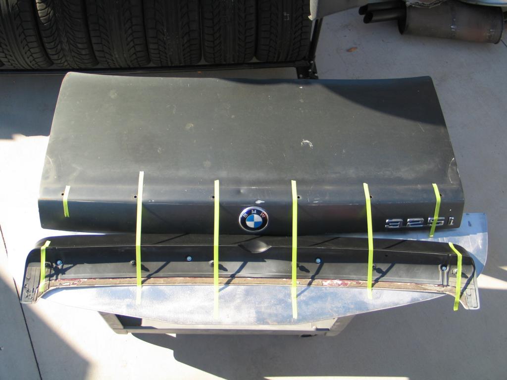

                          The IS, M-tech 1 & 2 wings for the E30 mount with 6 bolts/holes. The E28 M-Tech wing uses the same 4 center holes, but the 2 outer holes are further out (@ 1 1/2") than the E30 holes. Attached pictures are an #30 trunk deck & a E28 wing.
                              so this means i only have to drill two new holes then correct? The fore and aft position is the same?
