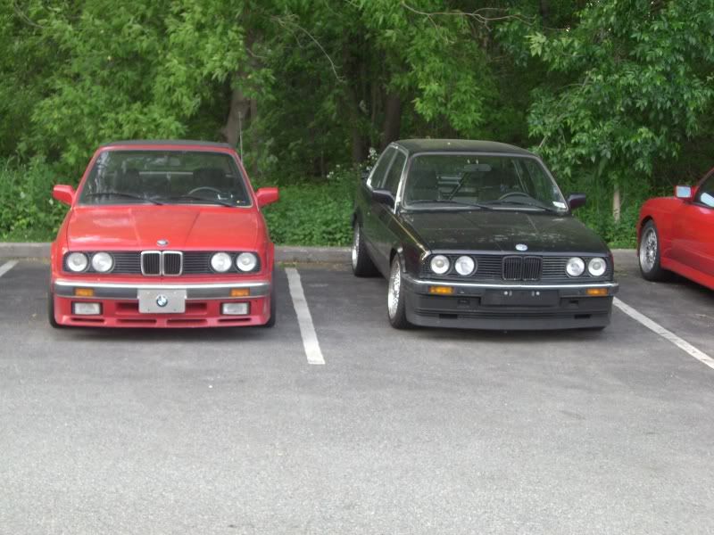

                    Took a little bit of cutting, but I got it to fit my car just fine.

                        this is what the late model version of that valance looks like. Like the mtech2 it bolts up below plastic bumper.

                              I can walk you through the steps on making it fit your car if you want. I just did it last week.
