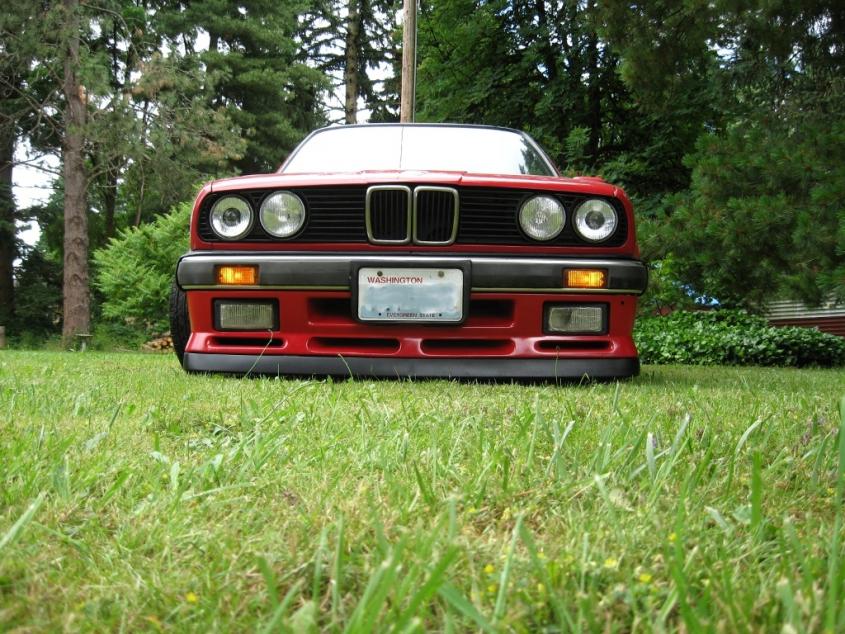

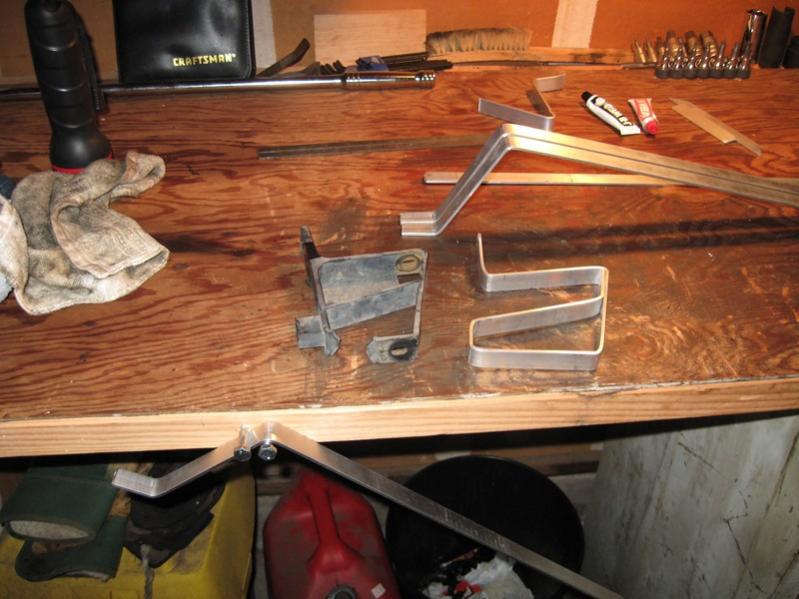

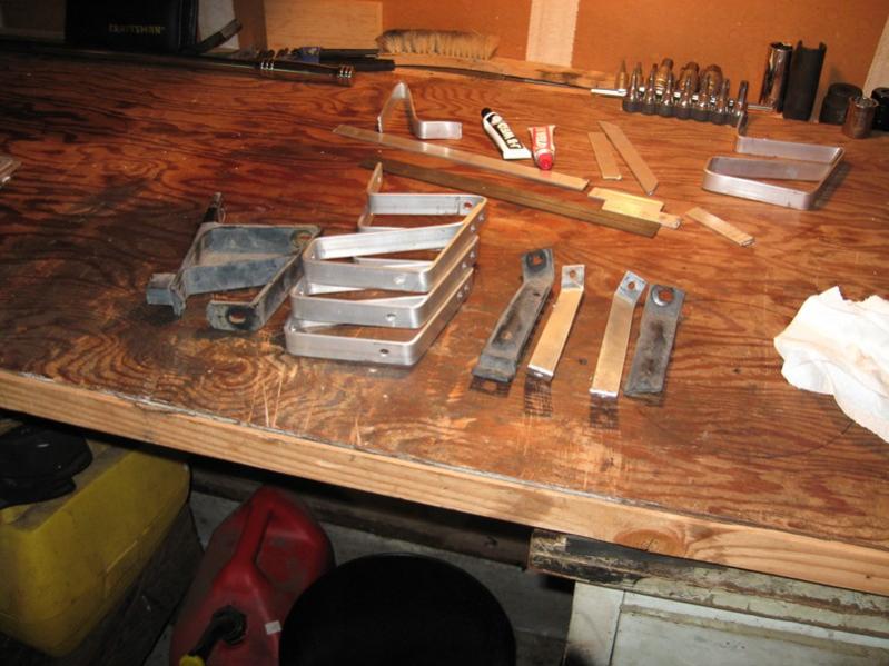

          I used 1/8" by 3/4" aluminum stock available at most hardware stores. Used a couple of bolts in the bench for a bending jig and some pop rivets. It's not going anywhere.

            +1. I used a vice & the same material, came out great. Aluminum is brittle so make sure you get your bends right the first time.

                          What lip is that on the bottom of the valence? Custom? Looks nice. Any more pics of your car?
