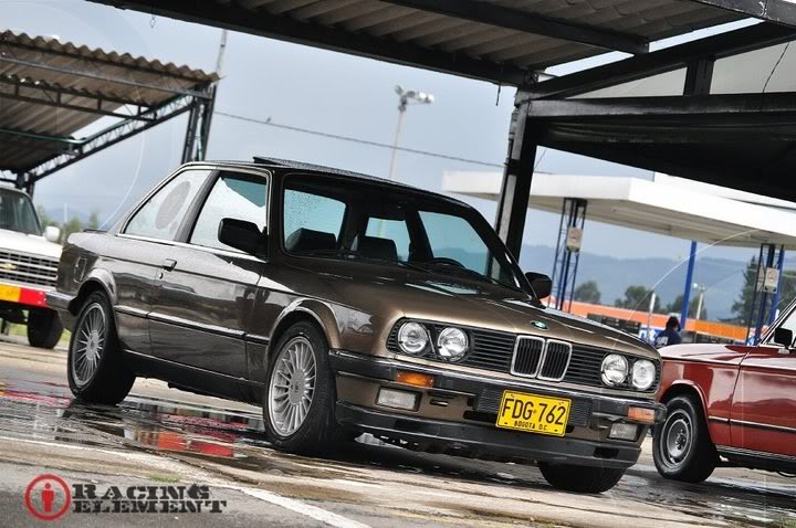

            Yes, I love the small euro bumpers - anything is better than DBs! Do you have to find them in european salvage yards? I've seen them new for Big Bucks.
Name:	euro bumpers.jpg

                    The Euro valance is a bolt on piece and replaces the sheetmetal valance on the US car. The one behind the eS/iS front spoiler. The 2 Euro cars you posted actually are 84-85 cars which have a slightly different valance than the 86-87 cars. In my opinion the 86-87 Euro valance is the best looking unit. It will share the same black plastic lower valance as the US 86-87 cars. Euro valance fogs are specific to that valance.

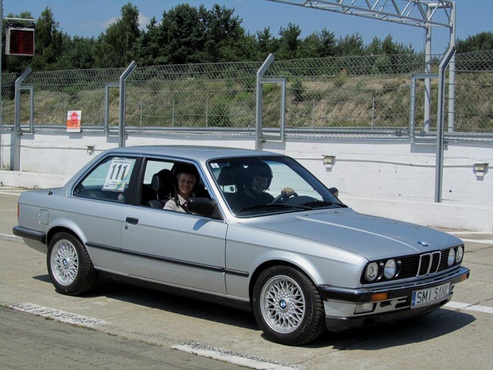

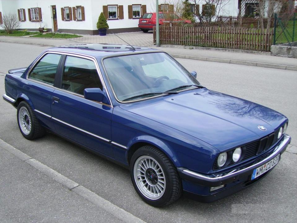

                        Originally posted by MR 325
                        ...In my opinion the 86-87 Euro valance is the best looking unit. It will share the same black plastic lower valance as the US 86-87 cars. Euro valance fogs are specific to that valance.
                        I think these pics are the 86-87 piece. Do I have that right?
Name:	Alpina OZ 15x7.jpg

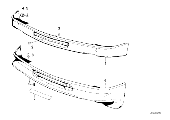

                        realOEm shows that panel with the center vents as 41331933772. I just searched under euro 87 320i. It appears you can order it from a dealer in the US for around $250, but there ought to be some used ones around. I just heard from a guy who scrapped one because of lack of interest (!). #8 below, although this drawing shows 4 vents - I thought the euro had only two rectangles..?
Name:	1986 valance 41331933772.png

                        • MR 325
                          • 37828
                          You are correct that's the 86-87 valance. The lower lip is the same as US. As far as the diagram on RealOEM, it doesn't always depict the exact part.
