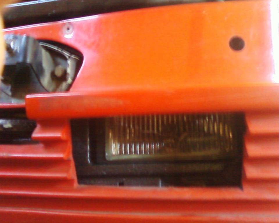

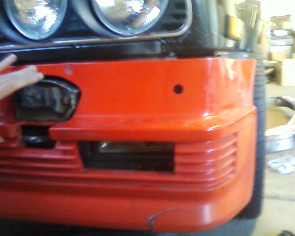

            I can try that, here is a picture of the problem. You can see the valence is as high as possible below the grille piece that holds the kidneys and the fog light slots don't quite line up.
            I have not tried it, but it seems if I use the above suggestion and mount directly to the valence it would collide with the bottom of the existing valence fog light slot.
            How have other mounted fog lights to their aftermarket valences?

              You could get a US valance and cut it so the back of the fogs don't hit it. The fogs on my Zender sat into the euro valance fog light holes. But then again I had the earlier valance. I also see that you put chrome around the grills. I did that to mine,

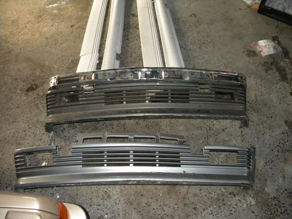

                    Sorry didn't see this until now, but it turns out the bbs is supposed to mount to the two piece early model valance. I found one in the junk yard on an '84 model and snagged it and repainted.
                    You can see the mounting holes on the middle pictures, just the same 8 mm bolts hold it on. I will be adding something to the back side of the valance so I can mount my fogs onto it and or remove them

                              IF you have the two piece valence, the top section that holds the kidney grill should be installed, but the bottom section should be removed. Then my bbs valence mounts to where the bottom section normally would have mounted.
                              That way when I mount the fogs to the bbs valence the lower section of the valence is not in the way. Does that make more sense?
