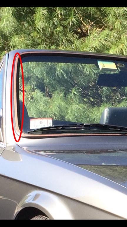

    What parts do I need to replace the piece circled in this picture?
    Is this the right thing:
    Part #51-31-1-884-402-M9
    'windshield moulding, chrome' from Pelican Parts, here: http://www.pelicanparts.com/catalog/..._pg1.htm#item0
    I am a little confused because the part online is chrome, but the part on my car is a black gasket with some kind of plastic piece in the middle that is now rust colored.
    Thanks!

    just replaced this. the window seal is two pieces, a black rubber, and a chrome plastic seal that locks the rubber seal in place. The back consists of one rubber and two separate chrome lock strips. i got mine from the dealer (for an arm and a leg) but ive heard pelicans parts are fine.
    They turn brown because the chrome has a plastic seal over it and that eventually gets eaten by the sun.

      or you can get a black plastic lock strip that won't get destroyed by the sun and is reusable...

        I believe early cars and verts have chrome lock strips and late cars have black ones. From what I understand they are interchangeable on the front glass.

          Thanks everyone! I ordered the parts.

              I just replaced my "chrome" lock strip with a black one. The only difference is that the chrome one has a plastic finish and is guaranteed to look like shit in 2 years whereas the black one is EPDM and will outlive us all.
