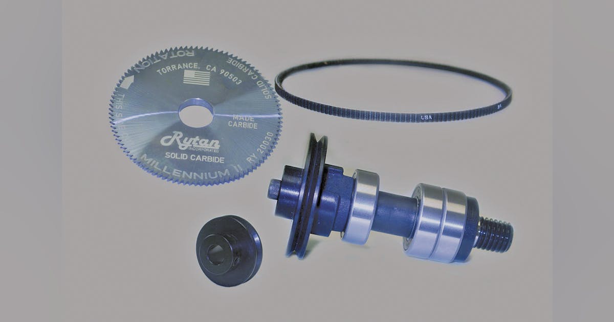

      Have been driving and calling around for steel key locksmiths in Chicago West burbs. Same story on every call from 5 different locksmiths:
      - "oh no we don't cut steel keys."
      - "they'll burn right through a $200 key cutting wheel in one try"
      - "I don't know of any locksmith in the area that cuts steel keys"
      Pretty sure this is a North America thing. Found a *great* article about steel key retrofitting for locksmiths:
      In approximately 30 minutes, locksmiths who own a Rytan RY100 or RY200 can install the Rytan RY103 Optional Carbide Cutter and Pulley Kit.
      For the North American market, locksmiths have been cutting softer metal key blanks, mainly brass and some aluminum. The only steel key blanks I can remember from many years ago are automotive. Most of them were gold plated presentation key blanks. Some were special orders for European model vehicles and only available in steel.
      North American cylindrical key machines - originating and duplicating - are designed for brass key blanks. Most of these key machines operate at about 800-1000 revolutions per minute (rpm) for high speed steel cutters.
      Steel content key blanks can dull or break the teeth of a key machine’s rotary cutter operating at about 900 rpm. A key machine that cuts key blanks containing ferrous metal should operate between 1600 and 2000 (about twice the rpm) equipped with a carbide cutter.
      Just need to keep hunting for the right locksmith I guess.
