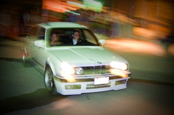

                          Bump. Did any of you end up mounting the E39 seal? How did it fit? I actually just ordered two (for both the top and bottom of the bumper).
                          I was about to pull the trigger on an EVO seal, but it's a bit short for non-M's, and it's 5x the price of the E39 lol.
                          Best pic I could find of the EVO seal on plastic bumpers:
