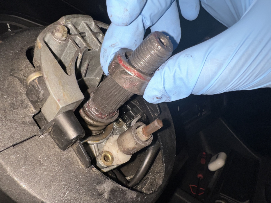

    My turn signal cancellation doesn’t always work and need to troubleshoot.
    1) when I had stock steering wheel, the turn signal cancellation never worked.
    2). installed Schnitzer steering wheel. Turn signal cancellation are working
    3). Removed the Schnitzer steering wheel but re-installed the same Schnitzer wheel few days later. The turn signal cancellation no longer works
    3) tried mtech 1 steering wheel. Turn signal cancellation does not work
    What could be the problem?
    Thanks !

    likely a faulty indicator stalk. there is a tiny arm that facilitates the indicators on the end of the switch. both the arm and the switch itself wear out over time. the fix is to replace the whole assembly. the switch and stalk can't be separated.
    edit : if the car was originally equipped with an airbag wheel there may be other complications. you may need to add a spacer, and the stalk may need to be bent / modified.

      Sounds like it's an airbag car and someone didn't install the wheel correctly. The wheel isn't down far enough to trigger the turn signal cancellation. When you installed the ACS wheel the first time, it worked so if you install it the 2nd time there is no reason it shouldn't work unless you installed it incorrectly. What year is the car?

        Yes, it is a 1992 convertible airbag equipped car
          Ok. That makes sense!
          It’s a 1992 e30 convertible with airbag steering wheel.
          I did notice there was an spacer which is removable
          I can try removing this spacer and mount the steering
          wheel again. If I am not mistaken, that spacer was there when the oem airbag steering wheel was on the car.
          thanks!

            Update
            removed the spacer. Installed the ACS wheel and the turn signal cancellation works correctly
            new issue
            no matter how much I tighten the steering wheel but, I do notice a slight wobble in the steering wheel. This occurs when I’m gripping the wheel not moving or driving yet
            What could I use to fix this ?
            a stack of washers.

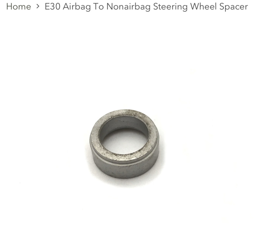

            Ideally if I had a spacer half the width of the one I removed
            thanks to everyone!

              Ok answered my question
              There is a bmw spacer specifically for non airbag steering wheels
              looks like this part will solve my issues
              Thank you for your help!

                Yeah, you need a spacer (or stack of washers) in front of the wheel to fill in the gap so that nut can hold the wheel down. The wheel will sit closer to the stalks now. if it's an issue for you, you can bend them back slightly. Also, make sure the white plastic peg has been removed and air bag sensor disconnected so you don't get the check light.
