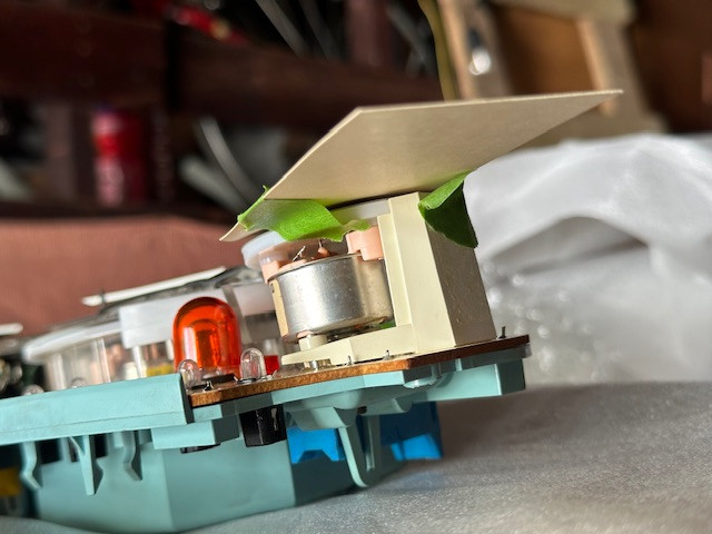

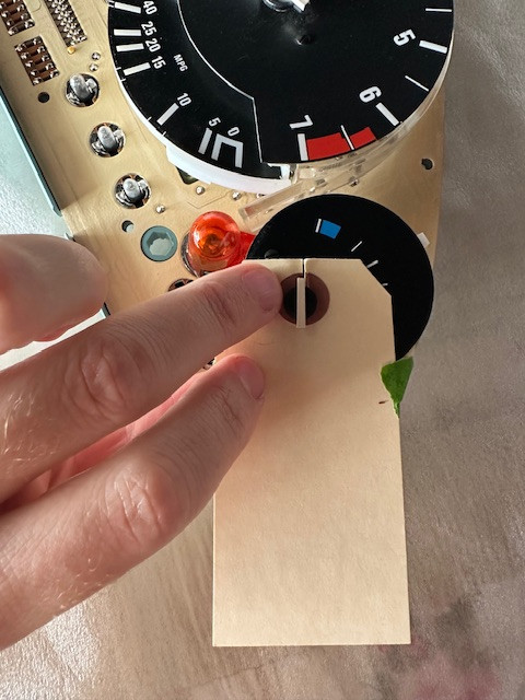

      I did this recently. Needle lifts straight off & snaps bag on, no adhesive. There’s a you tube video where a guy uses 2 spoons. I don’t recommend that. I used plastic trim tools & put a card stock on the face soI would not scratch the face.
      I was extra cautious & invented my own method.
      I cut a hang tag so that I could slip it under the needle & taped it where the tape wasn't touching the face . I also aligned the slit w the needle so i would know where to align it.
