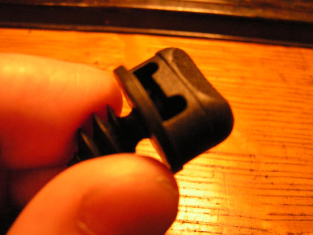

          Here's a photo of the correct clip that bmwguru007 referred to. Realoem.com lists the E30 clip as part #51471919171, but that is clearly the same E36 part that won't work with the oval shaped grommet on the OEM E30 mats. I'm at a loss on this one...

                You need 4 of the pictured clips. 2 per mat. They are all one piece, I have no idea why the etk is showing 3 parts.
                  Correct, the anchor is one piece with the top section that turns 90 degrees to lock down the mat. The one you're looking at is the E36 style, which is a three piece style and won't work with the oval grommet style mats.
                    I looked in the ETK and just ordered the floor mat hardware that showed up there, each unit was three pieces: the screw with a loop that goes into the under-carpet foam, and two rings that snap together and then go over the screw+loop piece. I cut appropriate sized holes in my aftermarket driver's floor mat, snapped the two ring pieces together sandwiching the mat, and then placed it over the screw+loop piece. 90 degree turn and done.
