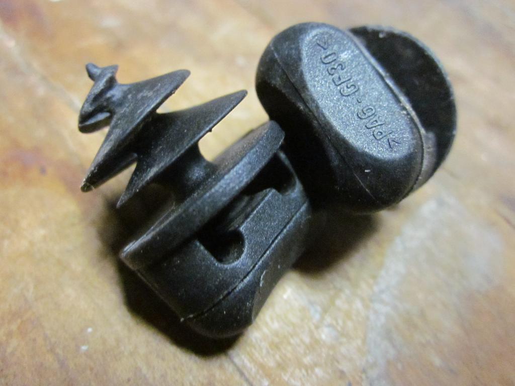

I'm thinking you could put some sort of plastic "washer" under the carpet that the stock anchors could thread into. My passenger side is fine but the drivers side are pretty much dead.
How Do Floor Mat Securing Clips Attach???
http://http://realoem.com/bmw/showparts.do?model=1231&mospid=47263&btnr=51_7489& hg=51&fg=95
You need part #3, p.n. 82119413234, price on bavauto (usually overpriced) is $14.95 per, 4 per car. Insane.Recent Rebranding!!

Wow thanks. That looks exactly right. Can't believe I couldn't find it. Too bad it's so pricey.http://http://realoem.com/bmw/showparts.do?model=1231&mospid=47263&btnr=51_7489& hg=51&fg=95
You need part #3, p.n. 82119413234, price on bavauto (usually overpriced) is $14.95 per, 4 per car. Insane.90 E30 325iComment
good find this. realoem only lists this part for euro e30shttp://http://realoem.com/bmw/showparts.do?model=1231&mospid=47263&btnr=51_7489& hg=51&fg=95
the other part number 51471919171 is the 3 piece floor mat lock. They are much less expensive, but if your floor mats have the oval slot in them then they will NOT work. If you bought new floor mats with an oval slot in them they should have come with 82119413234.

E30 mats are completely NLA now. :(
should have bought a set earlier.. they weren't even expensiveComment
fyi post on this forum says ECS they will have black mats in November.I BUY/SELL REFURBISHED CM5907s & CM5908s
