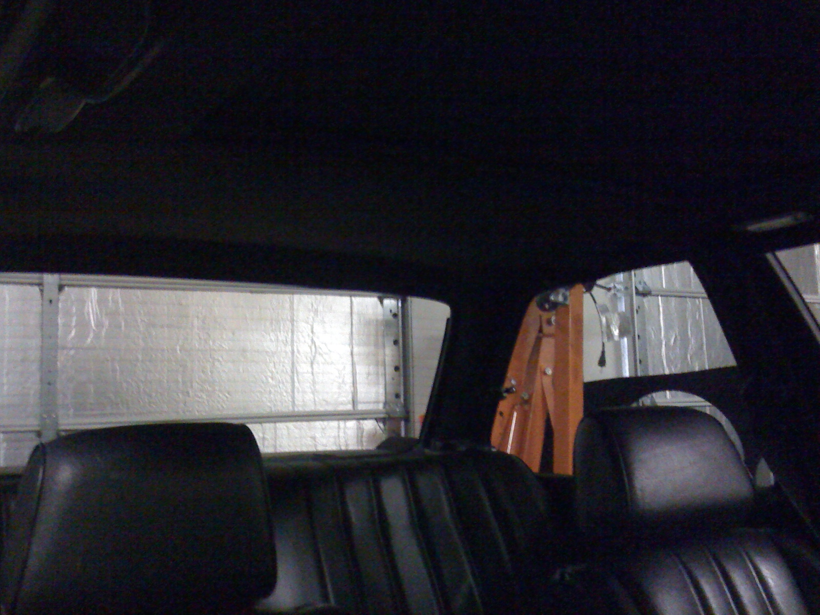

        I will pull it out and take pics today but here is the quick and dirty.
        Step
        1. Pull all of the seats front and back
        2. Remove Parcel Shelf
        3. Remove Sunroof headliner
        Yes it is a PITA but it is worth it.
        4. Remove front door and and side window seals
        5. Mask the hell out of everything and use drop clothes the rear window is the most
        important masking job.
        6. Wipe everything down with acetone and let it dry.
        7. Spray slowly and in multiple coats.
        8. Air it out for a day
        Bad pics in a second.
        8. Walk away alot because the back of the car will hold the fumes and mess you up.
        9. Un mask and reassemble
        10. Use paint clay to remove any overspray that floated out of your open sunroof.

            Can you try those pic again - outside with a flash maybe?
            Originally posted by Matt-B
            • BMW_TUNER
              • Jul 2006
              • 1386
              sorry they are phone pics, I will take more later.

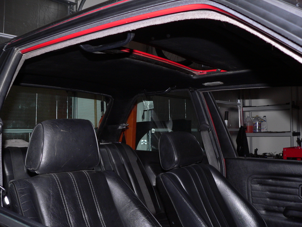

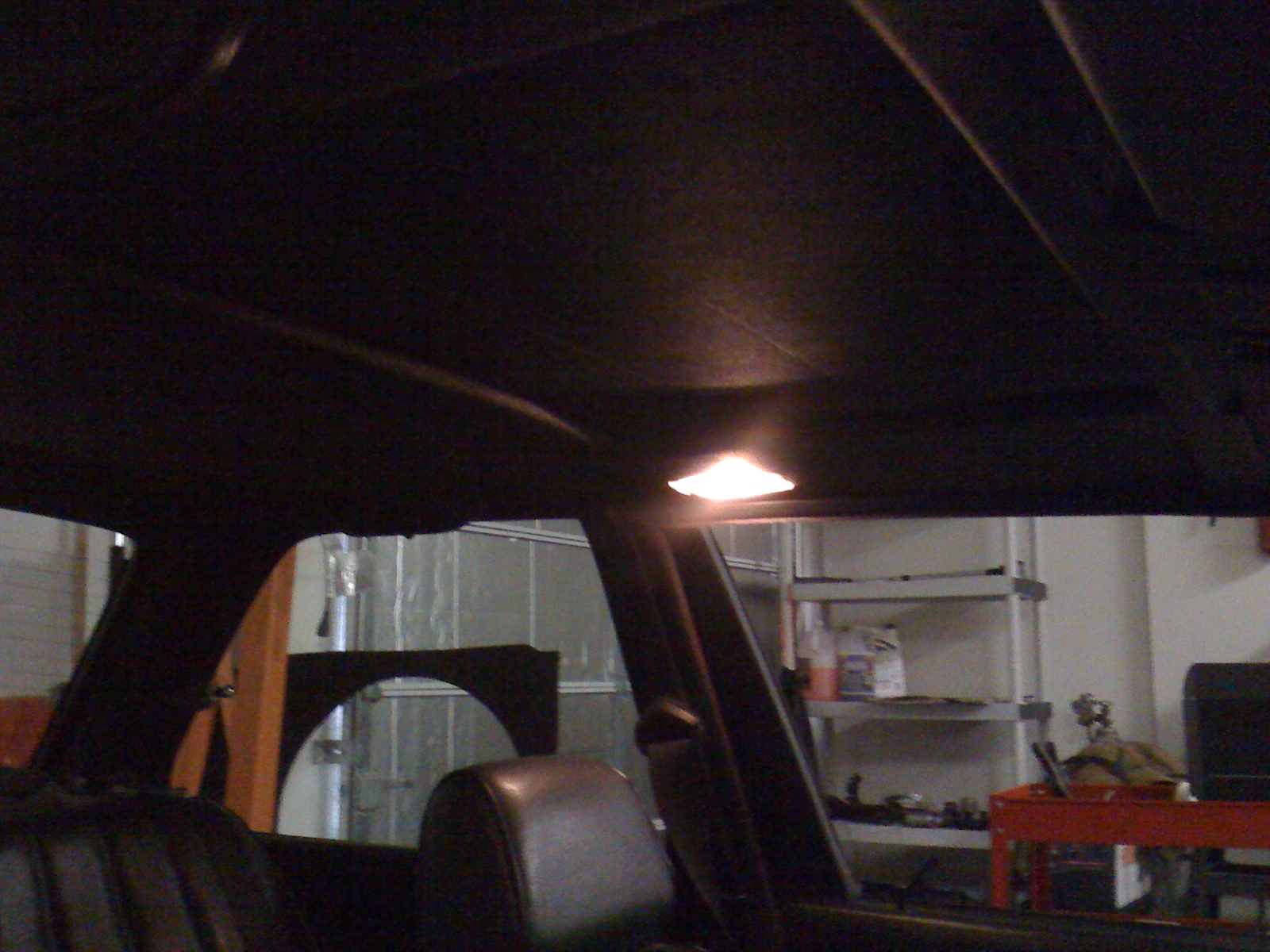

                  Any area that looks light is due to the flash coverage is complete trust me I went over it with a flashlight. It is a flat finish that only reflects under flsh and spot lights otherwise it lloks like freshly spray semi flat black.
