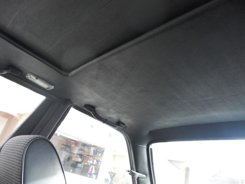

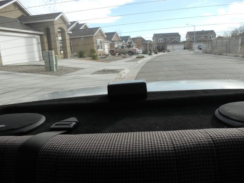

                      I ended up using Rust-oleum Painter's Choice "Flat Black" for my headliner and Duplicolor for my parcel shelf. There's a couple spots on my headliner that I'd like to smooth over, but overall, I'm more than happy with how it turned out. No masking, just rolled on with a sponge roller and a sponger brush for the hard to reach areas and a small paint brush for around the window seals. Anywho, here are the pictures. ;)
                      So much easier than masking everything off and having the leftover spray can smell. :)

                        That looks really good! Sorry for the noob question, but you didn't take the parcel shelf or the headliner out before doing this? If so, I'm doing this mod over the weekend.

                          Doesn't this make the car feel much smaller inside?

                            Wow, that roll on seems like it turned out great! When I read your post abt rolling, I thought you were nuts, but damn.. Im thinking about doing that.
                              Not at all!
                              I took the parcel shelf (along with seats) out because I was dying that as well. But it needs to come out to get enough of the headliner. Or else it'll just be patchy and messy. And no, the headliner is a pain in the ass to take out and with roll on, it was a breeze.
