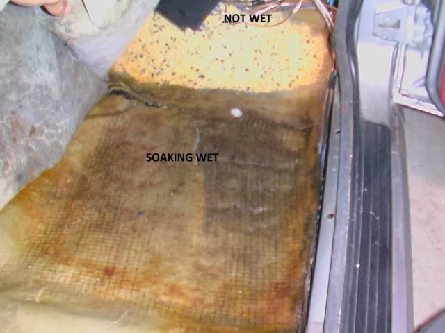

          Hey man I just found one of my leaks. The water trailed down perfectly in the corner from the a/c hose grommet not getting the upper carpet foam wet at all and, of course, soaking the bottom
          I just posted it above:
