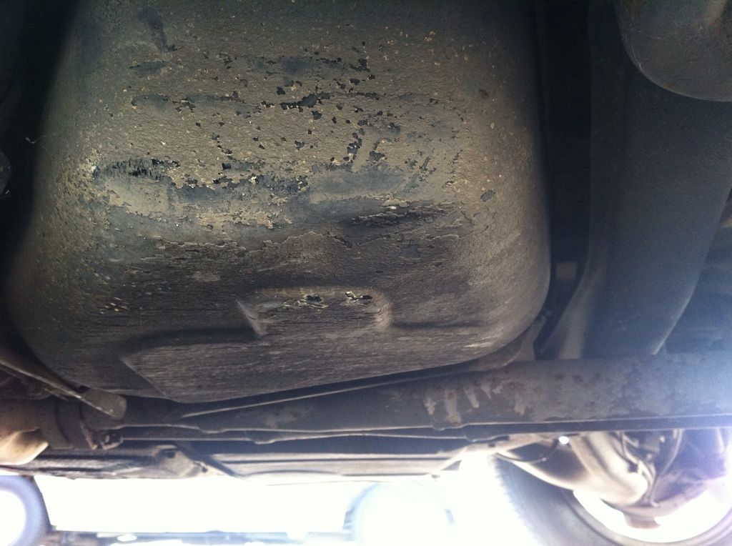

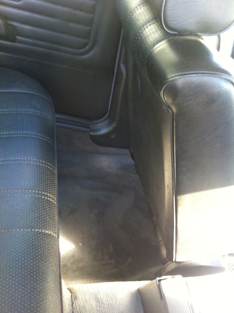

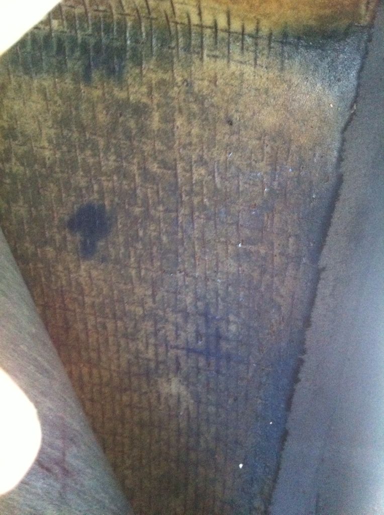

    I just recently found a leak in my 89 325ix. The carpet is damp right behind the drivers seat. I tried smelling it but could not figure out what it is. Here are a few pictures of the location and what is DIRECTLY under the leak. Thanks!
    Basic location:
    Under the carpet:
    What's under:

    does it smell like antifreeze? could it be leaking all the way back from your heater core?
    leaks don't go up so forget about looking at what's below the wet area.
