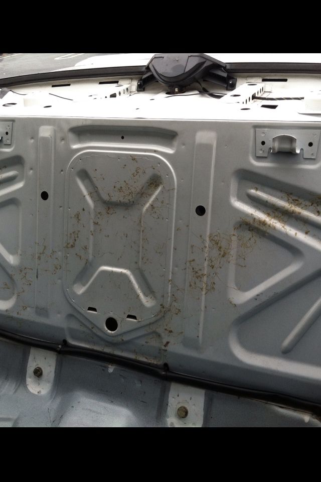

What product works to remove this glue residue
    Has anyone found a product to remove the factory glue that was used to hold the insulation carpet underneath the back seats. ?
    Currently driving completely gutted and would like to clean it up a little.

    Well, if I were facing that, I'd start with something kinda mild like WD40 and see how it worked. After that, I'd move up to something more aggressive like goop-off or acetone (albeit sparingly).
    Looks like some elbow grease will be required regardless..

      try goof off

        Some heat might help as well.

          Thanks guys will try the goo off and heat.

            Heat it some, scrap the bulk of it with a plastic scraper. Denatured alcohol dissolves a lot of different adhesives and will not hurt paint with reasonable exposure. Just put some on a rag and go at it.
              Gasoline, maybe?

                Vinegar, heat, and time.

                  Careful with the goof-off. It will strip paint if used to much or you scrub too hard.
                    Have had success with Trutle Wax Adhesive Remover
                      In have had excellent luck with this method in the past.
