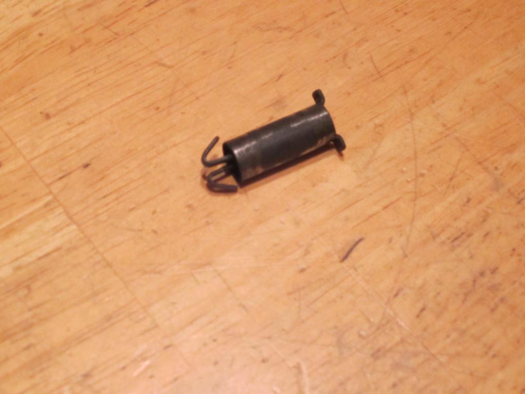

    The sport seats in my 318is are flawless, but they rock back and forth upon acceleration and deceleration. After looking into it, I found that the front "clip" bearing that holds the seat to the seat rails is loose, allowing the seat to rock. From the vendors I asked, the part is NLA, so I can't replace it. Has anyone run into this problem before and know how to fix it?
    Here's the part I'm talking about:

    Is the ""clip" bearing" damaged, or are the holes ovaled out?

        Not that I can tell. Looks fine to me, but something must be worn out.

                  Shouldn't you be able to use the bearing from some comfort seats? I'm sure you can find someone around here with a set of coups that wouldn't mind tearing out a bearing for you.

                    Ahh, not a bad idea. I'll see if I can find someone. I'm not sure it'd be an improvement over what I have, but it's worth a shot.

                      I've got an old comfort seat I use for parts - I'll check if it has this part.

                          This is what's in my Comfort seat. If you want to try it I'll send it to you.

                            That'd be great! PM me your paypal and shipping cost/whatever you want and I'll gift it to ya.

                              Im surrounded by seats and seat frames and am having trouble seeing a) how that part can wear out since it only gets wear when you tilt the seat back for rear seat access and b) if it did get worn that it would cause a noticeable problem.
                              Typically they are stuck tight and have to be coaxed out rather than being loose so I am curious to see if this solves your problem
