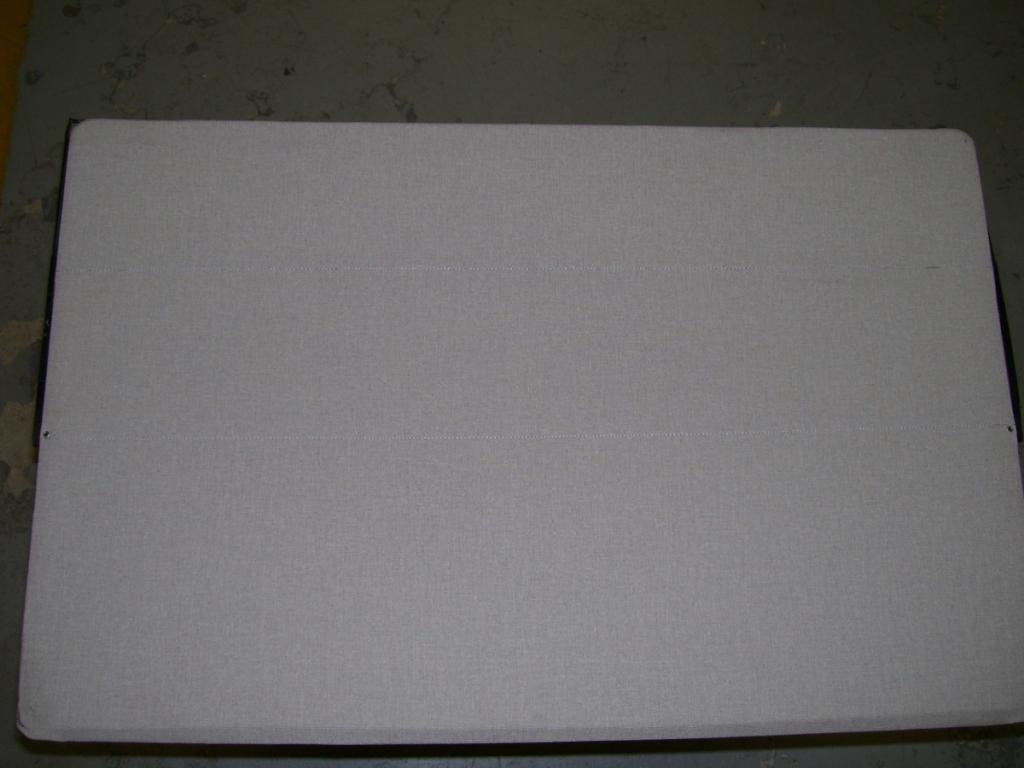

          Well looks like the only color option is gray....my interior/headliner is tan...probably wouldn't look good

            Just order the color listed for your model and year. The one I ordered for my '87 325e was listed as "Grey" but it was Tan. If you want a photo of the color, send me a PM and include a email address.

                This is a Grey sunroof cover that I purchased last year but tore during installation. In daylight it looks Tan.
